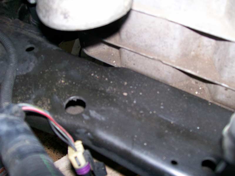

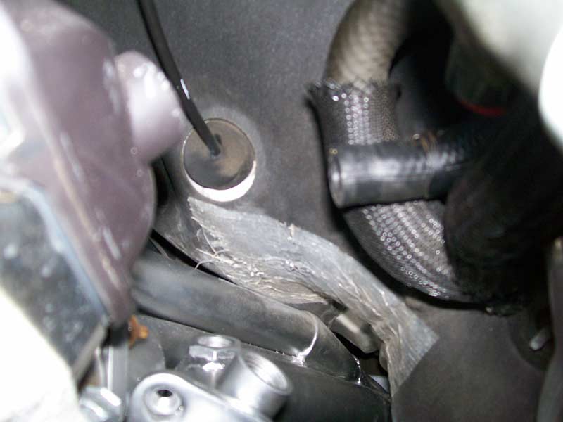

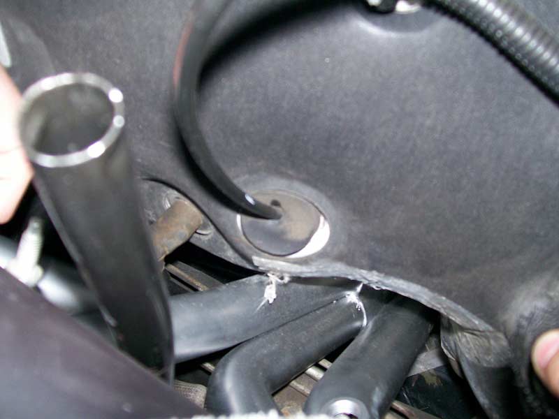

      OK I got the mount in.... this is what worries me now...
      The first picture is where the oil filter neck is... just a few inches below it is the sub frame... there is no way an oil filter will fit in there.
      The other 2 pictures are of where the headers hit the firewall. The flange clears fine, it's the tubes hitting the side of the firewall... it hits real bad actually. The engine will barely rotate up enough to fit the front dog bone mounts in, because the headers are pressing against the fire blanket on the firewall. I mean I can probably get it to all go in there, but shit it seems like those headers hit so bad that it would catch on fire or something...
        Simply remove the oil filter adapter from the 3500 then use a 10mm? allen wrench to remove the nipple from your old engine. The nipple should screw right into the 3500 and your filter will mount just like it did before.
        The headers.... no experience here but I would remove any of the sound deadening/heat material that is near the header and give the tunnel a smack or two to get some extra clearance. The rear header should rock downwards under acceleration.

              I agree with Marc on the oil filter. Just remove the adapter and make it so it mounts directly to the block at an angle.

                Ah... I didn't know that could come off my old block and I could put that in the 3500... that makes me real happy.
                The headers I still worry about... I mean I think they would be fine I am just worried about them burning that fire blanket sound insulation shit it is rubbing on. I doubt I could get very far with a hammer since I would have to pull the engine again to get a good swing.

                  Now these are the SS headers for your application right??
                  I'm surprised they are that tight of a fit. I knew they were gonna hit my firewall so I had to modify them beyond recognition...

                    The S&S headers are for Aleros and GrandAm's, however 3 different people that I know of have put them on w-bodies and reported it being tight but working... however they said the flange hit the firewall (well 1 person said that, the other 2 said they fit close but they worked without modification), nothing about the actual pipes hitting on the side. I mean I have the header half way bolted on there and it's tight but I know it will fit, as long as my firewall doesn't burn or anything.

                        I keep going back and fourth about my setup being OK. I will leave the fire blanket thingy if I can be sure it won't catch on fire or anything, otherwise I'll cut it away where it hits and maybe but a bit of header wrap on the header where it hits the firewall. Like mentioned earlier, when I am going forward the header will just want to go down, which is fine... reverse the header would want to come come up which is bad, however with my solid motor mount I shouldn't get anymore than maybe a clunk when I go in reverse... I hope at least.
                        Anyone else agree? I have no experience in dealing with headers...
