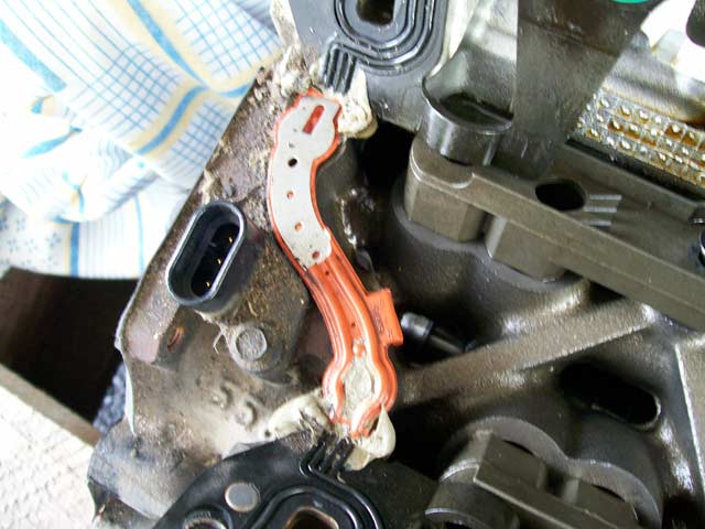

  • IsaacHayes
    replied
    You might be able to get away with using the LIM gasket again since they are so new. Depends how smashed it was. You could and then check it ever so often for vacuum and coolant leaks and make sure to do that regularly so if it does leak it doesn't trash the motor. The orange side things are used instead of lots of silicone. You could do it the old way with just silicone probably.
    That plug is the cam position sensor. They changed from a pigtail to putting the connector right on the sensor.
    The CPS is the 7x one that you have to put for the external CPS. It's located in the back of the block and is the tube shaped one. (pull the one from the 3100 or get a new one, but don't buy autozone ones, they are junk).
    The 24x is the horseshoe shaped one that you'll swap over with your crank pulley and timing cover from the 3100.

    replied
    Cam Position Sensor
    Since that is a GM PN, then yes, it will have the orange channel gasket.
    Leave a comment:
  • PCGUY112887
    replied
    Does that have the little orange channels too for the bottom of the LIM? One of mine ripped apart when I pulled the LIM off.
    Everything is so nice and clean, I hate to have to throw these away.
    Edit - btw what is that plug for in pic #1?
