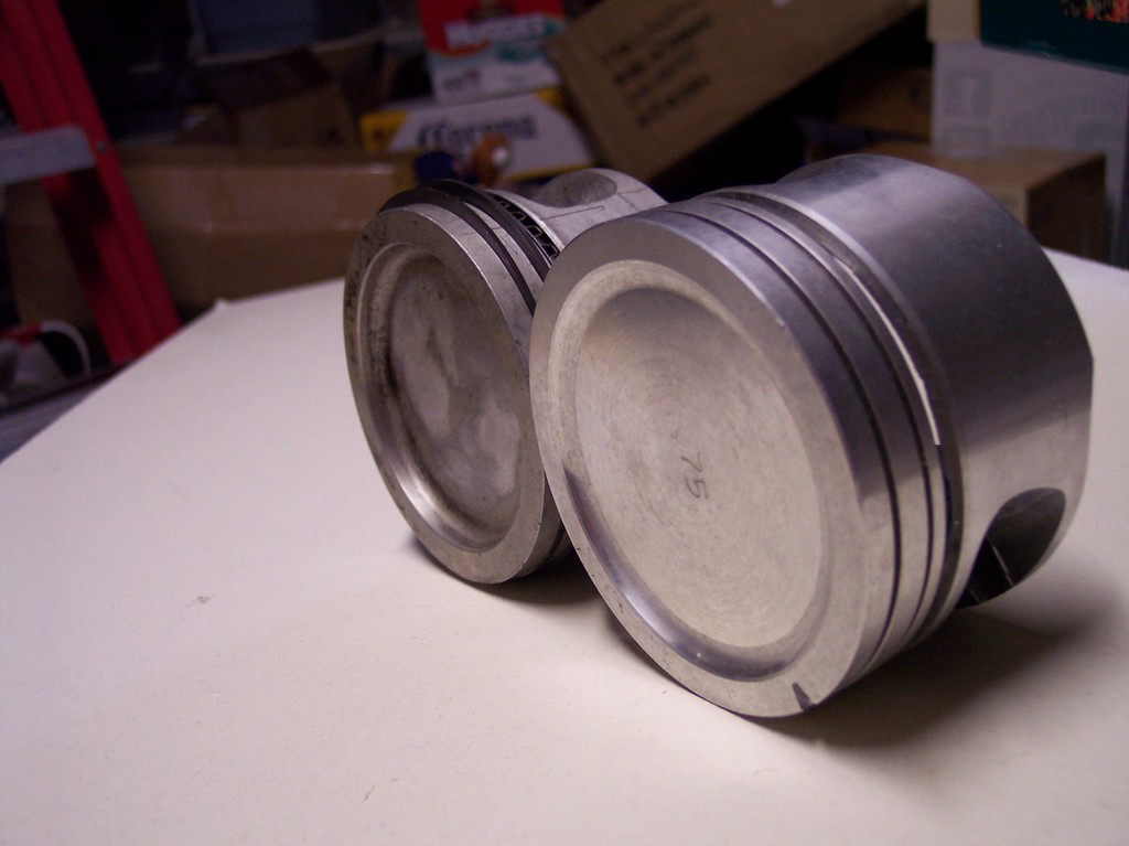

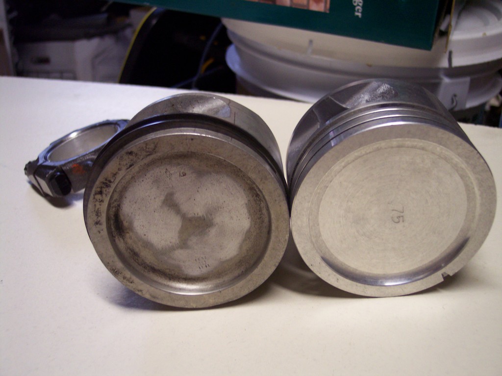

        the gen aluminum head pistons are about a 26cc dish. an s10 or camaro 3.1l uses gen 1 ironheads wich use a 12cc dish. you would end up with about 11.2:1compression. its not that high, still alright with premium fuel and would deffinitly require some tuning.
          Live life 3.7mi at a time
          • 4555
          Here's the difference (click to enlarge)...
