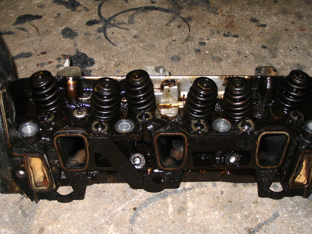

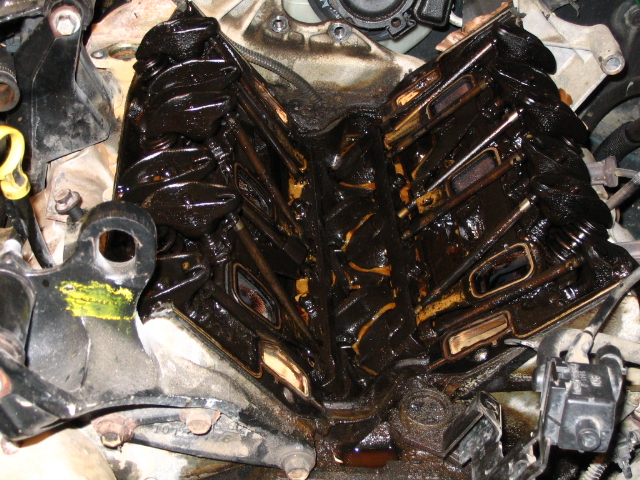

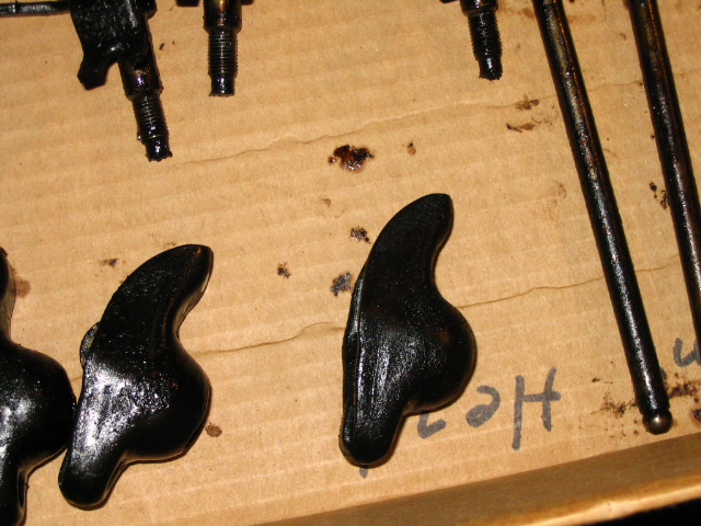

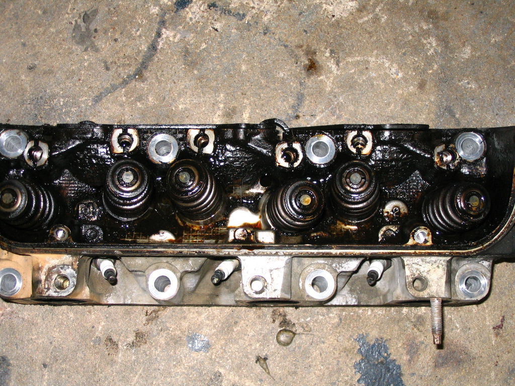

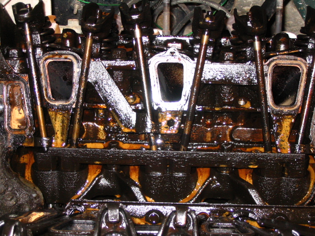

                  If you look at the pics he posted in his first thread, there are SEVERAL that show he has the stamped steel rockers. That is what I was basing a lot of what I said on.
                  Here is one of his pics with the stamped steel rockers:
                  and
                      and
                      For sure stamped

                            Don't have the notches in the heads do you?
                            Not sure what you mean,But here are a few photos
                              • 9186
                              Yes, you have the notches. Look in the 1st picture, and you will notice the grooves machined out of the heads where the rocker stud goes. It would be adventageous of you to try and find a set of roller rockers and just bolt them in. I have heard of people clearancing the LIM for the stamped rockers and grinding through the runner. Then your LIM is trashed. I'm sure someone around here has a set of rockers they'd be willing to get rid of.
