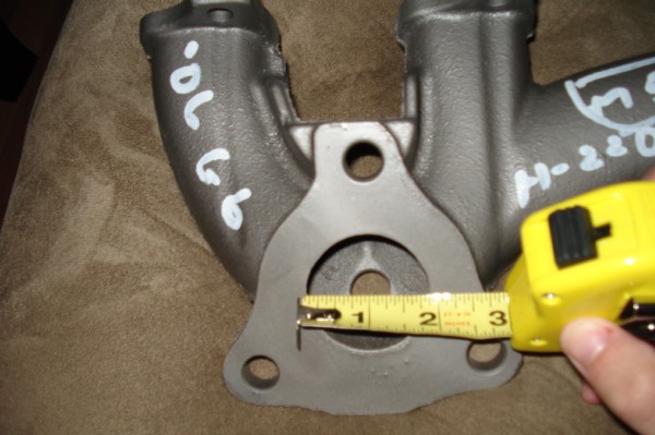

    Hey guys I need a few opinions here. Since we're having a hard time getting headers made for the G6, I'm open to anything. Here is a stock LZ9 manifold off the G6, the inlets of the manifold a fine they are large "D" styles measuring 1 6/8th wide, however the outlet into the cat is only 1 7/8th. Looking at the flange on the cats, they're well over 2 inches. I'm going to go pick up some gaskets to get the exact measurement today, I want to gasket match the manifold to the CAT.
    Thoughts?

    So all there is to grind is the flange it looks like? It doesn't taper down in the collector, just the flange opening is small? Looks like an easy mod.
    I say that would free up some power. Both with extra flow and reducing turbulence (if it doesn't taper and just hits that flange).
      Yeah basically, I took it in to the Machine shop and the guy said he can open is up quite a bit, he's also going to clean up the casting a bit, he's going to charge me an hours labor which is about 65 dollars. The damn gaskets where more expensive!

        $65 for a porting job is pretty cheap and saves you a lot of time of using a die grinder hhaha!! Is that for both manifolds?
          Do post any gains you feel!
          Yeup for both.
