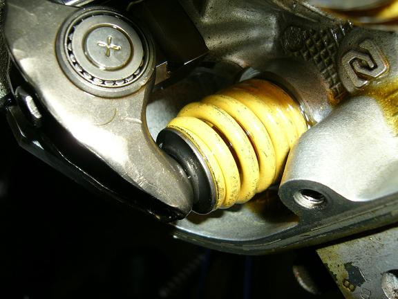

    the LS6 yellows are taking .559 lift on moonwell's 3400, no idea how but they aren't binding and he's making craploads of power..
    Did Moon measure for new pushrods? I am told that the Cammotion cams have a smaller b.c. than stock, perhaps he's not getting full lift ...?
    Here is a 3400 with .506 lift and LS-6 Yellow springs...
    You can see by the pic, there's not much room left.. And the hyd. lifters are empty.

      looks like there's room for more to me.

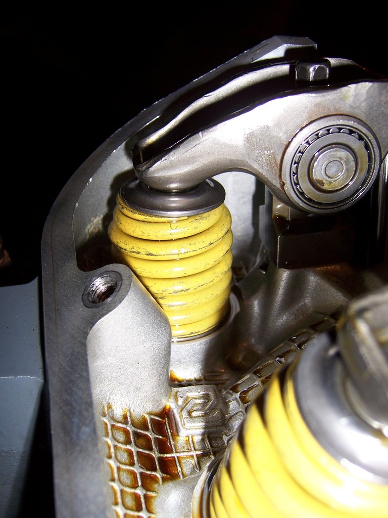

        I agree that it looks like room for more lift. My cam has .531 lift and I thought that my LS6 springs would work, but with the trouble that Superdave had without using actual spring seats I decided not to take a chance. Since I already have the seals/seats from the 3500 head gasket set I figured what the hell I might as well buy the better springs from Ben. With the Comp Cams
        #26986 springs and the stock seal/seats I should have no problem with coil bind.

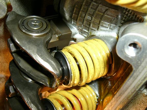

          You should take a extra lifter weld it so that it can't calaps then check for coil bind a hydralic lifter will calaps a good amount.

                Also here is 568 lift on a collapsed lifter and LS6 springs... motor wouldnt turn over at first till the lifter dropped then it allowed the cam to go the whole circle. Needless to say I went to the comps... I had to.

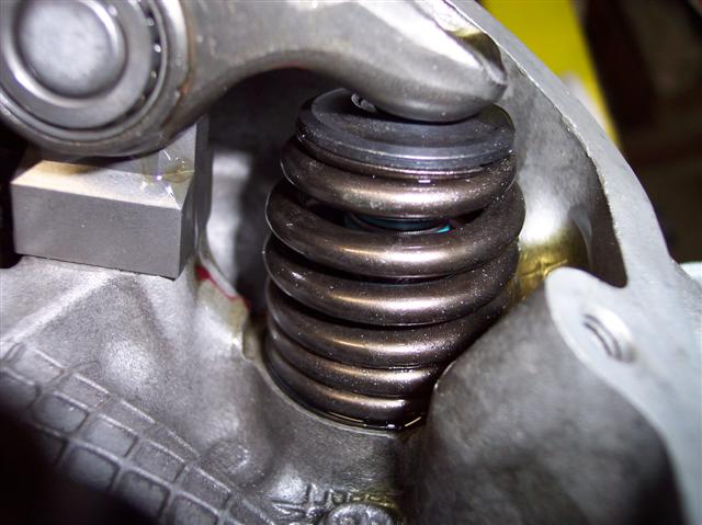

                                Here is a pic of .549 lift with an empty modified lifter and the comp 26915 springs and stock 3500 seats.
