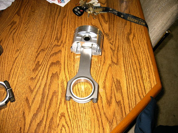

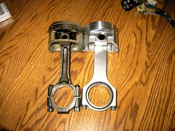

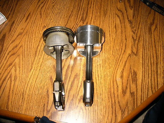

        i got some eagle rods on ebay really cheap. i had the pistons bored to fit the .927 wrist pin hole. the two weigh almost the same. i still need to have the big end of the rod machined but at 15$ a rod thats pretty good..

            do you mean the stock assembly and the one you have are about the same weight?

                they seem to be of pretty high quality. these rods will take well over 700 horse. my goal is 600 whp on 20 psi

                            no theyre floating i could push them in
