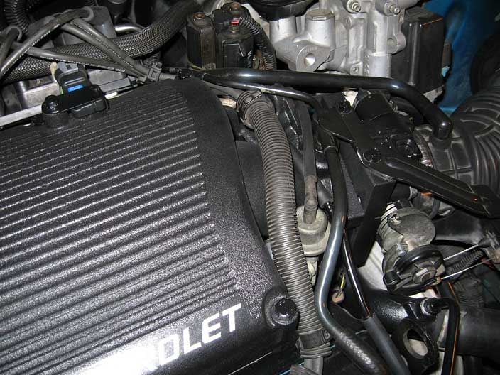

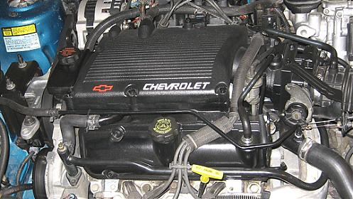

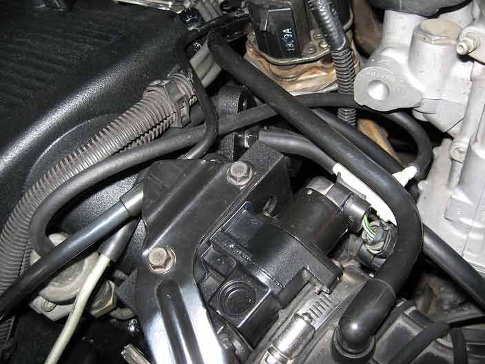

                The 3500 plenum front tabs are for a wiring harness to snap onto. I thought Monte's used those... On mine I took off the front tabs, and the side tab by the alternator cause my car doesn't need them. You can also take off the square on the right side by the TB neck. The EGR you can just bolt a flat piece of sheet metal between it and the EGR or some 1/8" or so aluminum and remove the EGR and delete all the codes with DHP. You can then use the EGR plate and drill a hole and install a vacuum nipple if you wish.
                Take the IAC/EVAP thing off and use a 1/4" NPT tap and put a barbed fitting there. I ran this to my FPR (and vacuum ball). I'll get pics in a second. The MAP you splice in to your harness. There is another vacuum port by the brake booster port, it may or may not be installed with a nipple though. Mine was and I used this for my vacuum cruise control. You could use that for the vacuum ball and the other one for the FPR if you wanted. That's about it really.
                The way I routed my vacuum lines it all looks factory. One picture shows it before I put a 90* elbow on the FPR.
                    Thats what I needed there....thank you
