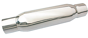

                Here is a plan. Good or bad?
                I can use the Schoenfeld sanction approved muffler (100 db) at the collector and not interrupt flow.
                I can put in auger baffles down stream or the Moroso spiral muffler.
                The Moroso knocks about 6-8 dbs off the sound on its own.
                Comments?
                Arn
