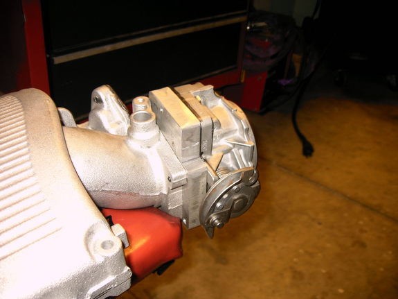

                    Just noticed in your sig that you used a 70mm TB from a 4.3, did you make an adapter?
                    • merlot566jka
                      • Nov 2006
                      • 570
                      #40
                      yup. it was really simple. made templates out of packing tape. then stuck them to a 5 by 5 piece of alum .25 thick. drilled the holes, and discovered that the adaptor can be bolted to the intake with the top two bolts, then you can drill out the manifolds bolt patern right through the tb and there is no problem. the two lower intake studs are what holds on my tb, and the one upper tb bolt is botled into the adaptor.
                      kinda hard to explain, but it works out nicely. i guess a pic would do justice. when i get a new linkage for the tb, ill post pics. my linkage has alot of play, so im going to get one from kinsler racing.
                      and i used a roll of gasket paper for a gasket

                        im going to start producing these things again this summer. i had to stop making them when i moved to chicago for school.

                          Idle adjust screw? You mean throttle stop screw? The IAC adjusts the idle. The IAC counts should be around 25 at idle. So if it's less, that means the throttle plate is open too much letting too much air by. If it's higher then it means the IAC has to open more to keep enough air to run, the plate is a little too sealed.
                          How much does your Fiero weigh? I know they aren't as light as everyone thinks but it's in the 2000's.
                          How did you cut the bore hole for the TB? I'm thinking of using the 65mm 3.5L TB possibly if I can find a cheap aluminum plate to mod again, and possibly rig my cruise to the linkage.. If my other plan doesn't work out.
                          Heh, gasket paper, I need to get some of that. I'm using the thin cardboard spacer that game in my FelPro gasket kit to cut gaskets out of LOL!

                            LOL ^^^ I've used a Buwiser 12pk box, Frosted Flakes box, and the same cardboard you are taliking about. Just rubed some motor oil on them to soften them up a bit and they lasted quite some time.
                            Funny the things that can be pulled off in a pinch.
                            Thanks for the heads up on the TB Merlot. Just got one off ebay for $25
                            I will then write a CNC program to make an adapter in case one is needed later.
                              What TB is that?
                              • IsaacHayes
                                Mr. Orange.
                                • Apr 2006
                                • 6030
                                #45
                                That is the 4.3l 70mm TB. ^^^^ EDIT: It may be 75mm performance version but is a 4.3l TB for sure. Several TB's have been used on the 3500 plenum, some overbores. I think Mars_Man is using a bored mustang TB that's 70 or 75mm. The mustang bolts up without an adapter but has no IAC.
                                Yeah I put motor oil on them too. Keeps them from sticking so you can re-use them LOL. Plus I didn't trust the white clay surface on one side of the cardboard and didn't want it stuck to the metal to clean off later.
