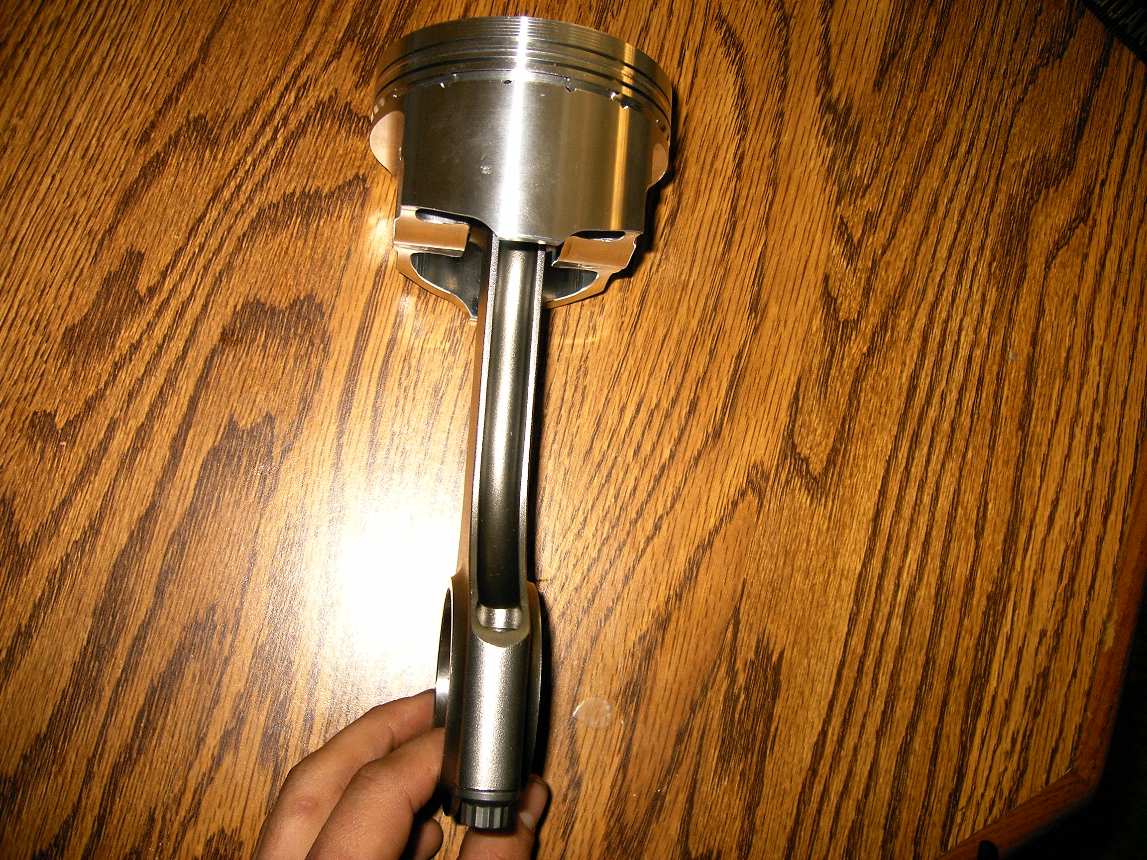

                    how about the bearings? if the big end has to be machined would i use the 3.4 bearings? or are the oil spouts in a different spot?
                    • MidnightriderZ24
                      • Jan 2005
                      • 699
                      before picture and after picture of machining. stock bearings will work.

                          If you go this route, have your SBC bearings narrowed also. I got SBC 6" H beam in my 3.4 and that's what we did to the bearing for proper fitment.
                            Live life 3.7mi at a time
                            • 4555
                            Or you have to have the anti-rotation tangs machined into the rods and caps and use the 60* bearings.

                              factory bearings will work. theres a slight offset, but according to my machinist, its not the first time seeing it, and it will not be an issue. ill find out for sure though
