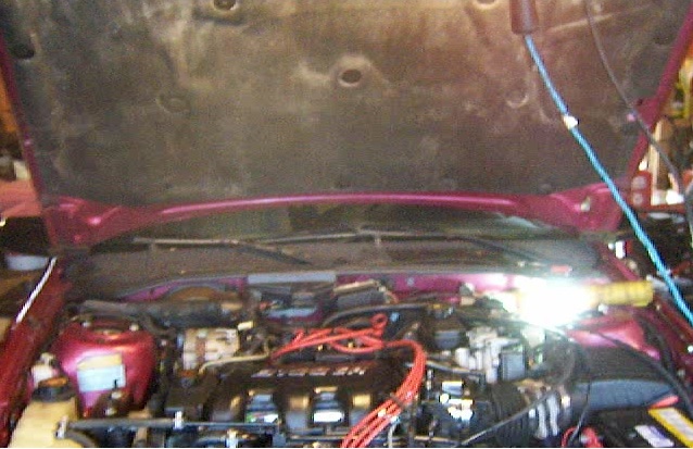

        Well i did a little work.
        Dropped frame rails, cut off exhaust, replaced inner tierod bushings... Yes I do use my own products
        and then installed the transmission.
        PICS...
        Since I forgot to get a Belt, I can't really install the motor since the side motor mount would be in the way later, so yeah that will wait till tomorrow. I'll just go get the other fluids I need for tomorrow now.

                  Well its friken loud and lopey... cant judge its power now because well its open headers so it sounds like its reving to shit at 4k to my ears so I didn't romp on it, and its raining so I have no traction... Oh and I definitely need to add washers to my shift accumulators or bump up my modulator pressure... shifted wicked soft, and the torque converter is very bearable I'm suprised... way better than the PDQ one I tried a long time ago.
                  Oh and the radiator is cracked... so yeah gotta wait till monday for one of those... FUK!
                  Vid is uploading so hang in there.
                  A little teaser pic while it uploads...
