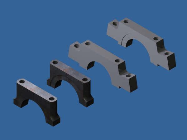

                            I'd be in for the 4 bolt mains... as long as they aren't outragously priced. What material/process are you planning?

                              love to have some 4 bolt main caps for my block.

                                #45
                                gonna be made on a cnc mill out of a 4130 modified alloy so its at least twice as strong as stock and still machineable and honeable. should have a quote back anytime.
                                heres stock vs proposed:
