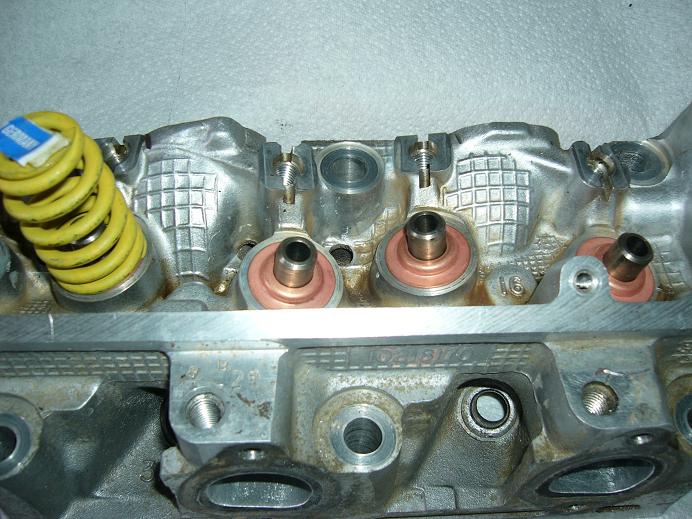

              I have a new set of the spring you see on this head, I bought off ebay a few months back but after seeing where they were made I was afraid to use them. If you think there good what seats and seals would I have to use?
                Live life 3.7mi at a time
                • 4555
                What do you mean "where they were made"?
                If those are the LS6 springs, then the LS1 seats are fine, you might have to open up the center hole with a die grinder to fi the 3500 heads. Use seals from a 1991 Cavalier 2.2L (FelPro part number SS 70816), you'll need two packs.
                As mentioned in that configuration on the 3500 heads, I measured a solid heightt of .5613" and you should be fine with up to .520" lift or so.

                  they were made in germany but advertised as oem.
                    those have the same tags as my old yellow LS6 springs.
                    they're good for about .510 lift, and will handle that H260 cam without a problem.

                        they arent "advertised as oem" they ARE OEM just made over there by another supplier. did you really think that GM made all their own parts or that all of them were made here? the LS springs are just fine...except for this one...http://60degreev6.com/forum/showthread.php?t=40983

                              As I said before, so long as those springs have the same stacket height (coil bind) then you are goo to about .525" lift without problems.
                              You may want to use the stock springs for cam break-in with the lower seat pressure to avoid wiping a lobe. I went straight to the yellow springs on a new cam, we'll see what happens
