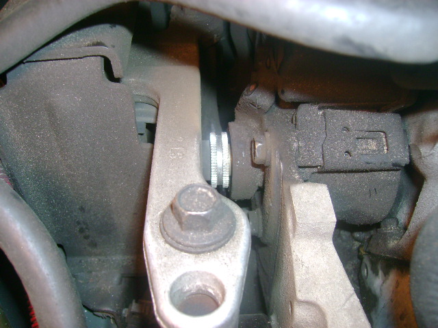

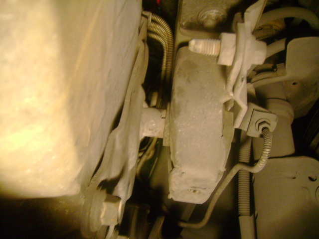

      Currently I put the car up on stands bacause the engine shifted on my wa home from work. I made it home but when it did the ps pully rubbed against the top mount and shattered so I lost my belt. Since I have to lift the motor a bit anyway to replace the mounts, as well as replace the pully, I figured it was a good time to taackle the ps and ac delete.
      As you can see here the spline to the power steering pump is NOT where it is supposed to be.
      I belive this caused my problem. I think that the pole on the end of the tranny(left) should be inside the rubber block on the mount(right)

        Not sure how you did the attachments, but they don't work...
