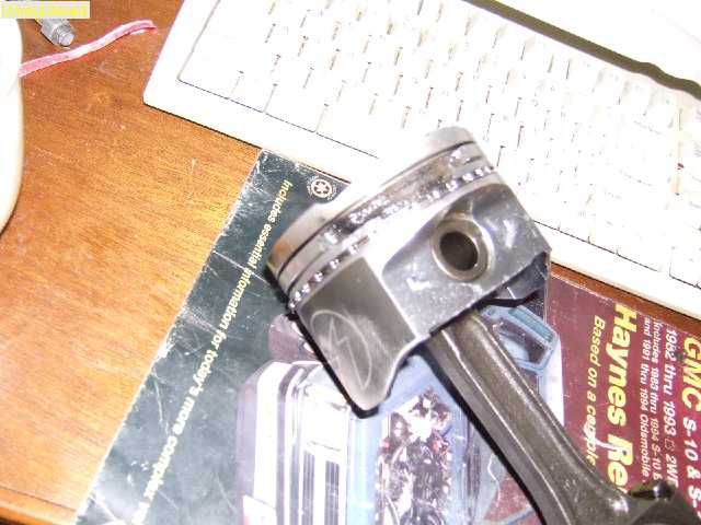

            #6 Piston had 90 psi cranking pressure, the rest had 190. I put some oil in the cylinder and the pressure went up so I pulled the engine, and stripped everything down.....#6 piston has cracks in both ring lands. Leaving in those speedpro 3.4 DOHC piston when I supercharged it didn't pay off. Obviously, 10.9 compression, 11 psi boost and full timing must of been just too much for the lands to take. .......sooooo my question for you boost guys is, should I drop the compression to stock or do I really need forged pistons at this point. Do GTPs, WRXs, ect have forged pistons?

                    Point taken. I was running alot of timing. I though I would be safe because propane is a slower burn and denser charges take longer to burn too. I'm running a malory unilite distributer so I'll have to block out the centrifugal advance mechanism. Here's a pic of the damage, BOTH lands busted off...
