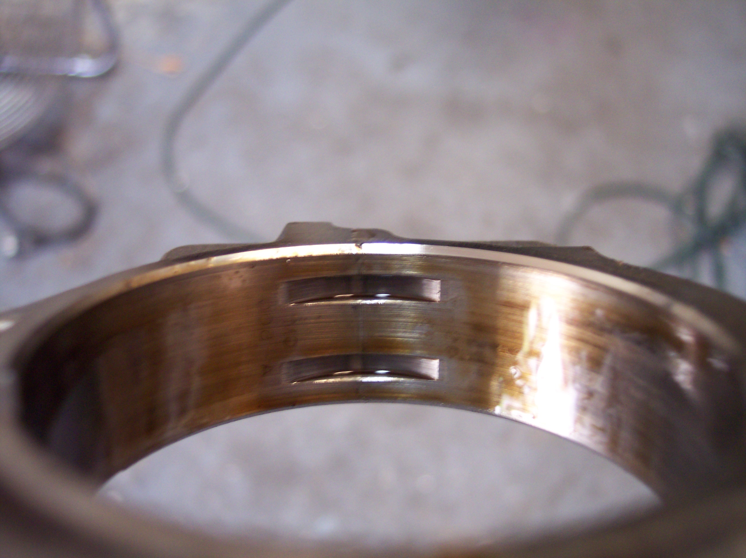

                    There's actually more to it than that. The not only is there no flt for the tang to touch, but there is a notch on both the cap and rod. From a machinist's standpoint, I don't see why this was necessary other than saving very little time on the complete machining process. All they had to do was remove the cap and put the divot in each part individually, instead they used a slot cutter to mill both the rod and cap together.
                        [ATTACH]2011[/ATTACH]
                        That's what I was saying earlier, I just took to long to post a picture of the rod. What 3400-95-.. is probably saying is that since it is a fractured cap rod that maybe the only sure way to notch it for the bearings without a possible more expensive process for GM, as the slightest deformation in the caps fractured intermeshing surfaces may result in an incomplete seat of the cap.
                        I nearly ruined one of my rods by putting the cap on 180 degrees rotated and starting to snug the bolts down, once those jagged surfaces are deformed, you can pretty much forget saving the rod.

                            While looking for someone near home in Tampa Florida to do an offset crankshaft grind, I mentioned the rod notch that might be constributing to bearing spin and was told the notches were only there to center the bearing in the rod and that it is the cap pressure that keeps it from spinning which suggests that the cause of Superdave's bearing spinning is likely a reduced cap pressure from rod stretch. Perhaps a little roughing of the contact surfaces and some loctite might really help after all.
                              #134
                              Yeah but at the same time you can't argue that the tangs touching a flat surface that in-fact will stop them from rotating would help preventing a bearing from spinning.
                              I also cant imagine that a centering tool would be on ONE side of the rod only... it almost seems like if they wanted it to center the bearing the would put it on both sides...
