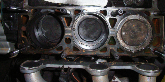

    Does anybody know/recommend any engine builders with experience with the 60deg engine family? After almost 10 years, my stock 3.4L camaro short block finally failed (Probably had nothing to do with the fact that I was trying to step up the tune...) Engine was pulling hard, almost 12psi, then pop. I am running a B&M Supercharger with about 6 PSI on the street and 9psi at the track, ran the 12 PSI pulley setup exactly ONCE, oops. See photo look at piston #6 on the top left of the piston.
