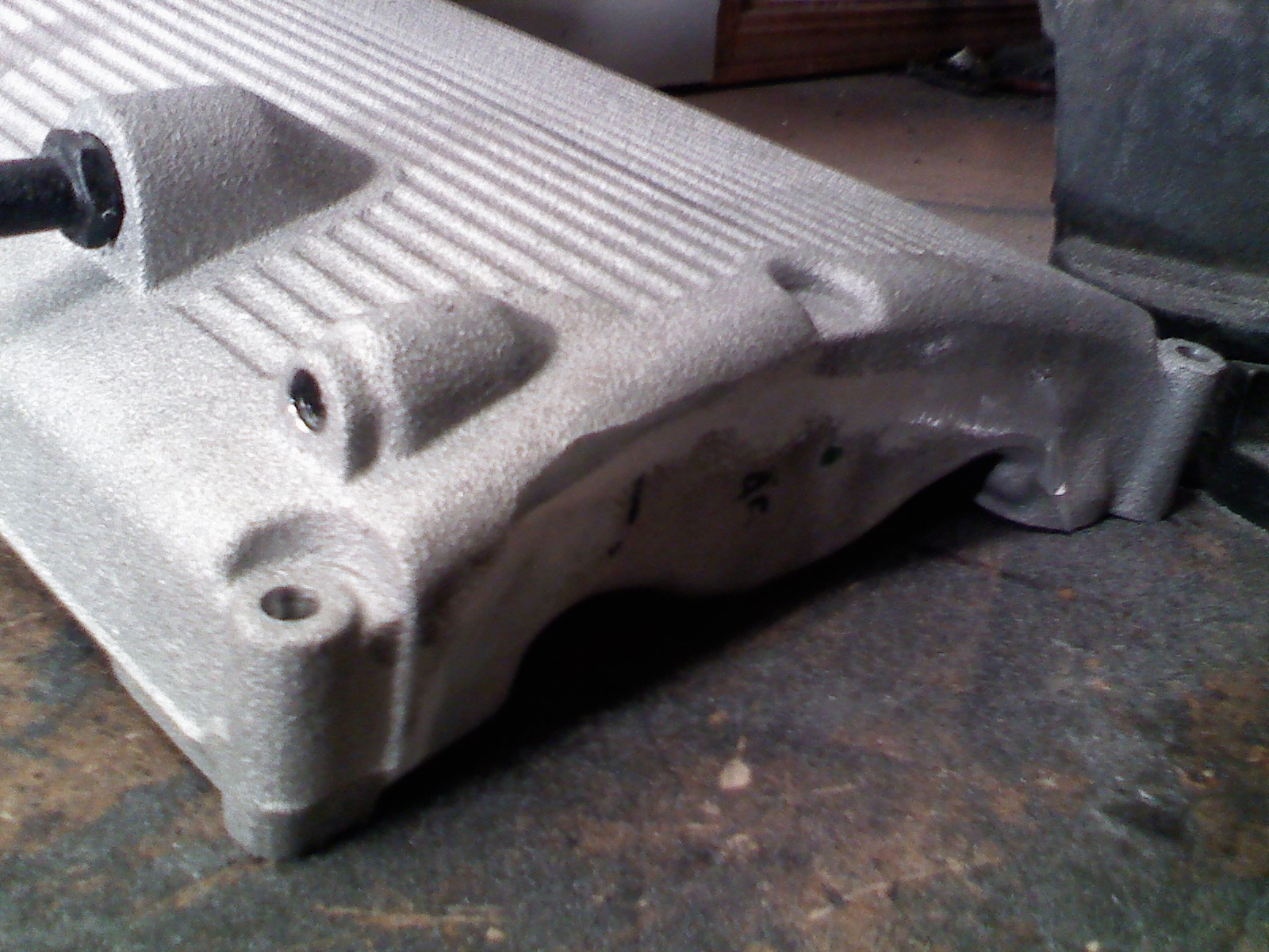

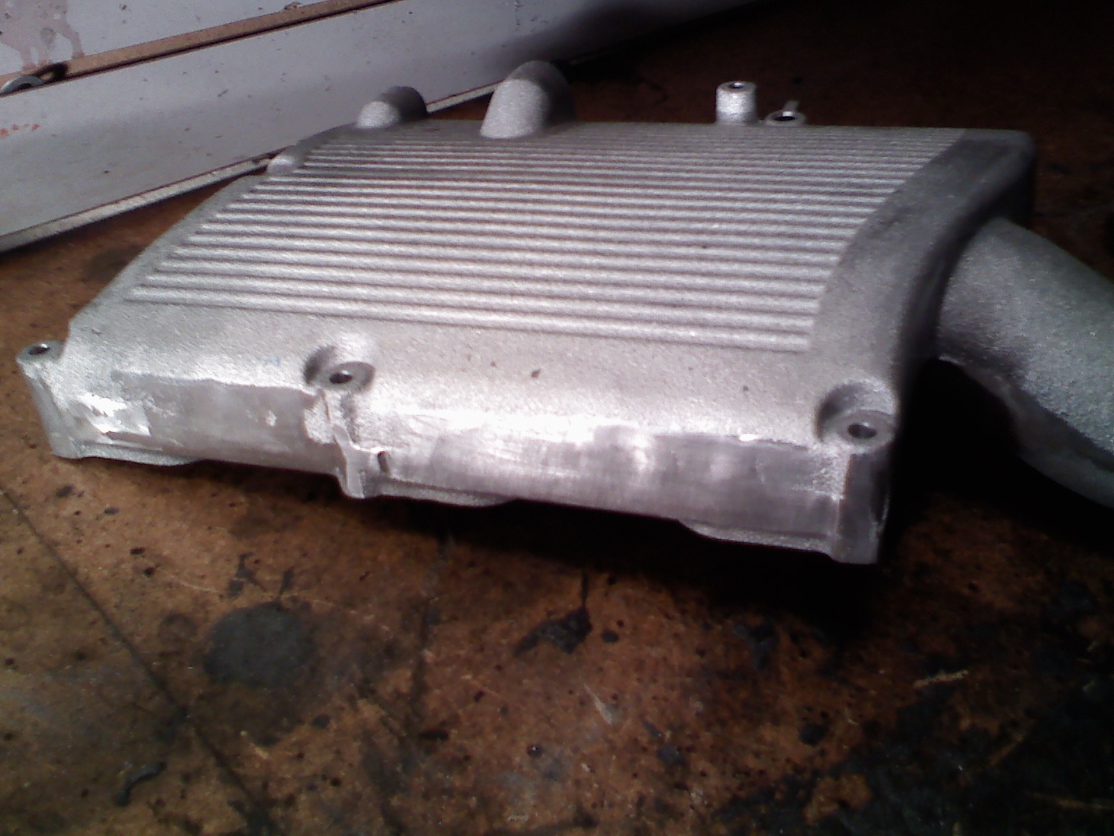

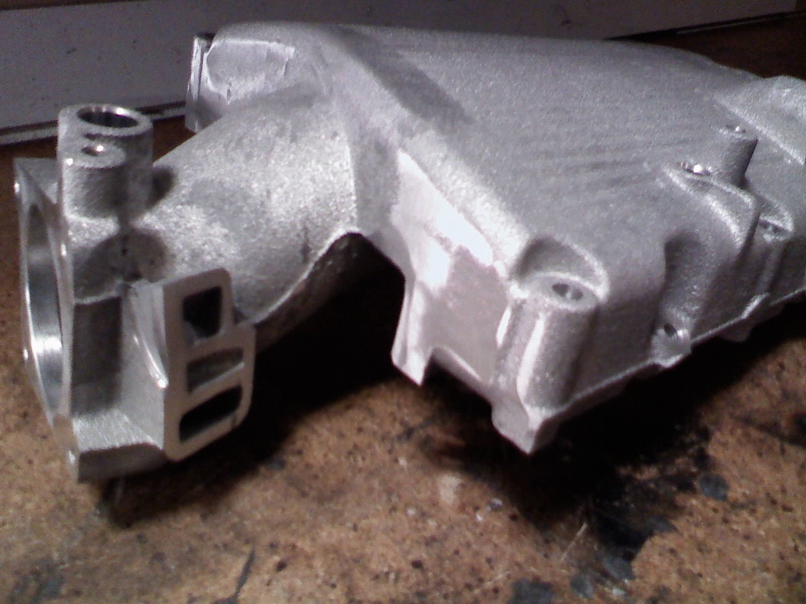

today i got some more stuff done. i stayed a little later after work and used the infinate shop air and cut off the evap mounting port, and the egr port off of my 3500 plenum. i gotta find somebody to tig it for me since i dont have access to a tig. i also utilized the unused casted section on the plenum and tapped it for a vac port. also ive been working on cleaning up the appearance of the plenum, got some of the useless mounts and casting flaws sanded down... lots more work here..[SIGPIC]

Looking good did you do the porting yourself?
