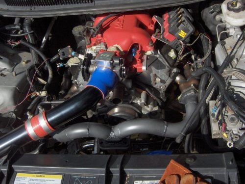

                  Ive never seen one in person before. Is it just the bolt-holes or are the over-all dimensions different? Is the sump any larger, smaller, any protruding bosses?
                  Heres a pic of my current pan and mounting position.
                  [IMG][/IMG]
