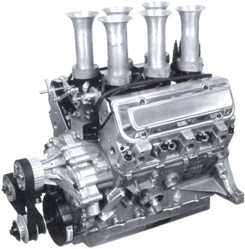

                umm...
                Bills I was meaning to ask a while back, but is that your motor you have for an advitar..

                    umm...
                    Yes, one of them - I have a turbo Fiero, a 2004 3400 minivan and that motor, which is installed in an old MG with a body conversion.
                    See http://www.rhodo.citymax.com/i/non-rhodo/enginebayj.jpg

                        Originally posted by BillS View Post
                        I was going to say, I've seen you beautiful car on the V8MG site...
                        Look like a fun car to drive...

                          2000 lbs. + 200 BHP = tons of fun!
