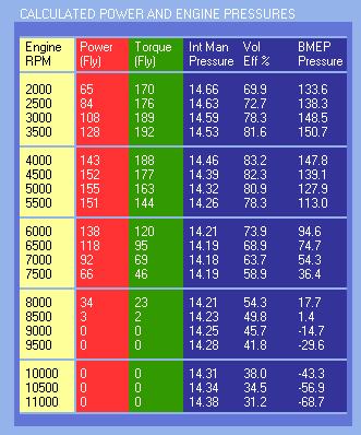

          I've been playing with Desktop Dyno 2003 on a iron head 3.1. Using approximately stock head flow, a 2030 cam with 1.6 rockers and the stock 52mm throttle body, the program calculated the following power and torque:
Name:	stroked 2.8 guess.jpg
          Not much point in revving the engine past 5500 rpm but does show + 32 ft-lb peak torque and +20 HP peak power compared to the fuel injected 2.8.
