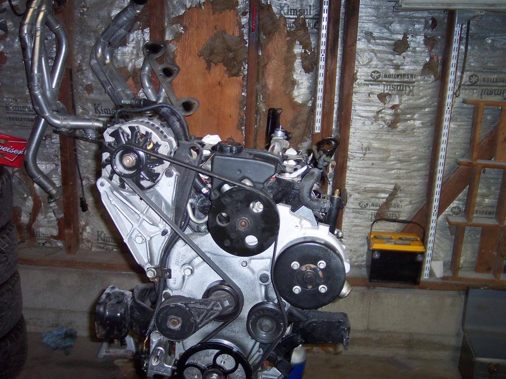

    this is how most of us do it...
    • americasfuture2k
      • May 2008
      • 146
      looks like you just bypass the pulley all together. but you have a P/S pump, i do not. so that can kinda throw things off.
      well taking a second look at things, your belt routing is pretty different than mine.
      here is how mine goes according to the belt routing diagram on the engine

        That's how I have my belt setup.

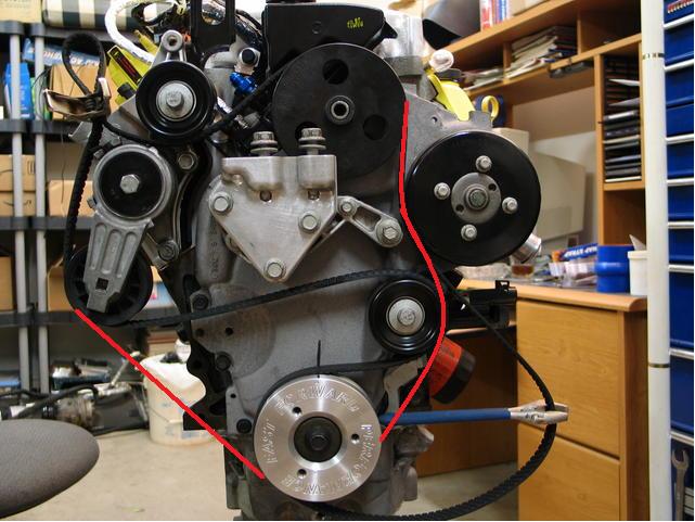

              Originally posted by americasfuture2k View Post
              not getting it from that post. doesnt look like that would work without an AC pulley in place or AC delete pulley. all that looks like is you bypassed the PS pump pulley. thats not the issue in this case.
              The PS pump isn't deleted it's just not in the picture but what that post is trying to show is the idler pulley just above the crank pulley to the right was changed from a smooth pulley to a ribbed one.
              In the attached image I have the stock belt routing then a red line where it routs now.

                ok, so what pully and belt do i need for this? that link for partsamerica doesnt work since PA isnt a part of advance anymore.
