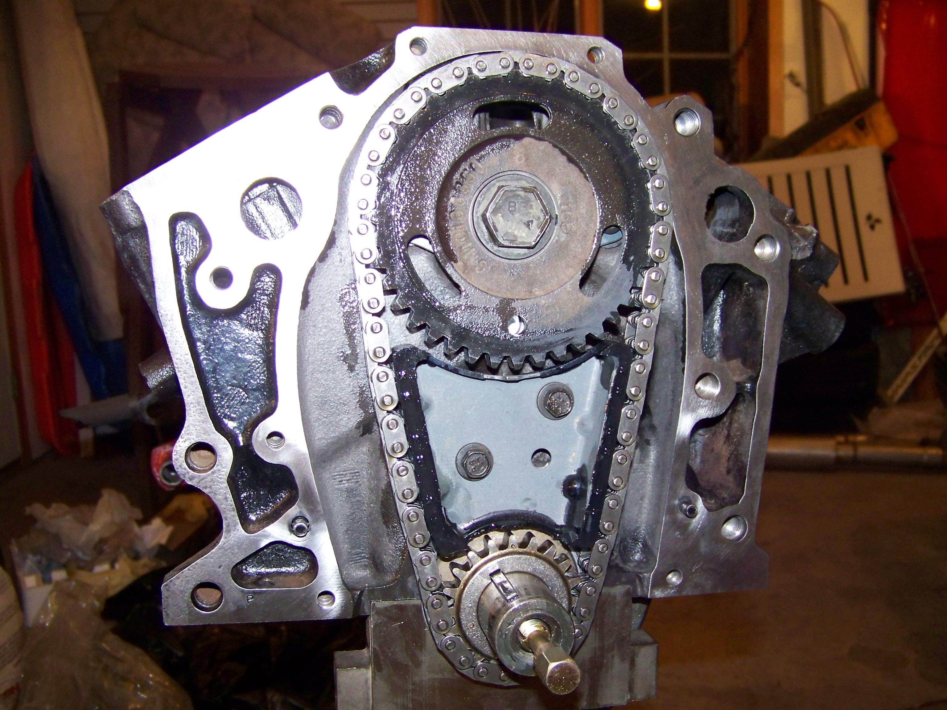

    Also, what is a good tip so that I don't lose my timing marks. (it's probably different from doing an old carburated motor I can imagine.)

    no, for changing just springs, it isnt really required to have different pushrods, stock is strong enough. for assurance i used ls6 springs, on stock pushrods and 12psi, no problem. As for keepers and locks its up to you, stockers are fine as well.. for clearance, proper machining to the seats will need to be done for the correct spring install height (lots of people break ls6 springs due to this factor!!!). as for the piston, unbolt the rod, and take the cap off, and just tap it out through the top! timing marks use this picture: small round hole on cam sprocket facing down, and arrow on crank drive gear must be facing up. #1 cylinder sound be at TDC.

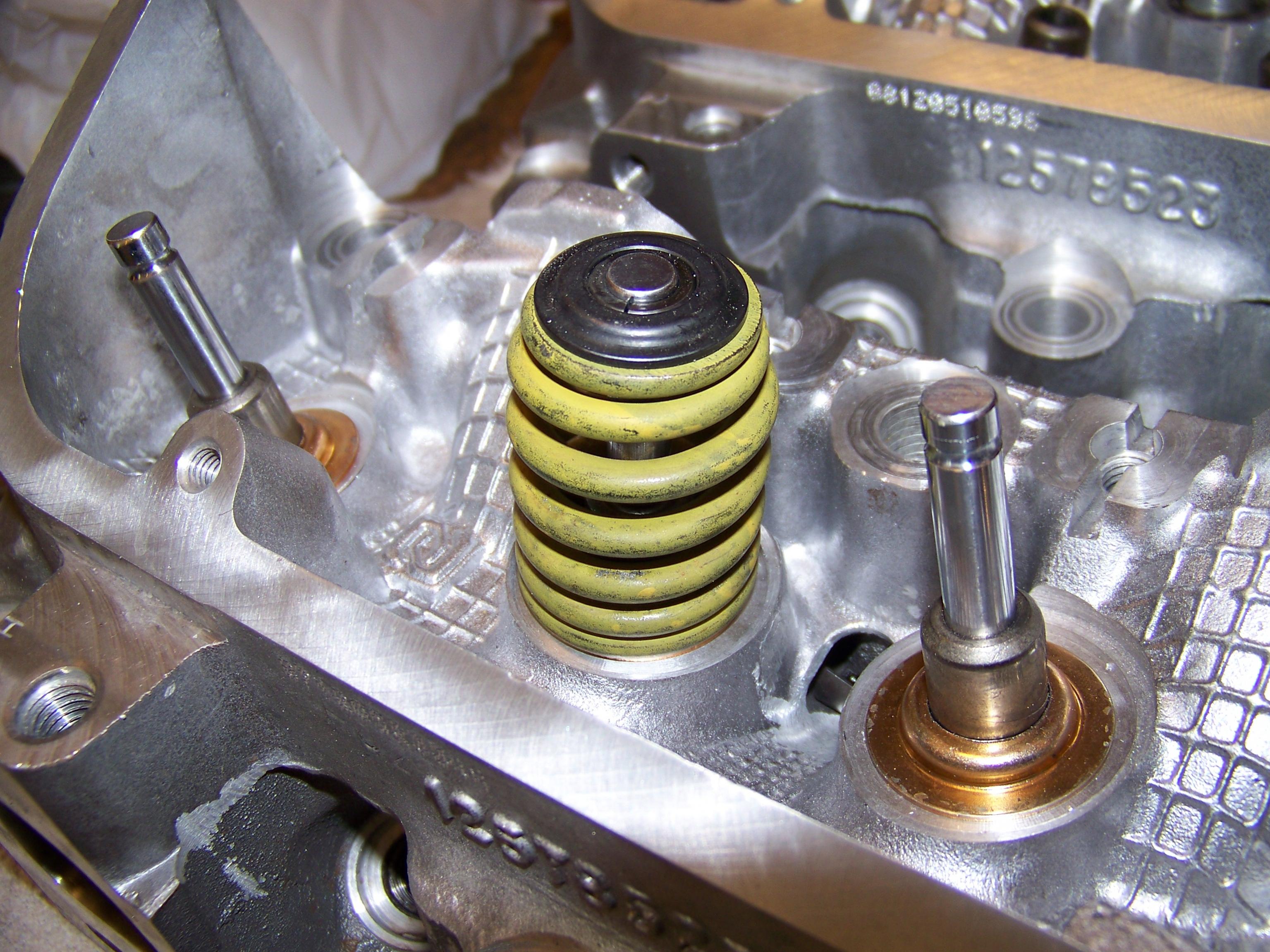

      here is a picture of the head machined for the correct ls6 install height. - note this is a 3500 head, but still the same thing will be needed for a 3400 head.

        how far down are those bad boys machined. I have a booklet I am making up for my machinist of everything he will need to do, so far i ahve him refacing both heads, retapping the plug holes on both heads, porting polishing and installing the springs and hardware to go with it, what is the measurement I will need to tell him, and will that number apply to both the intake and exhaust ports?

          yes both seats will need to be machined. stock height on a 3400 is 1.700'', ls6 install height is 1.800''. so 0.100'' machined off the seats.
