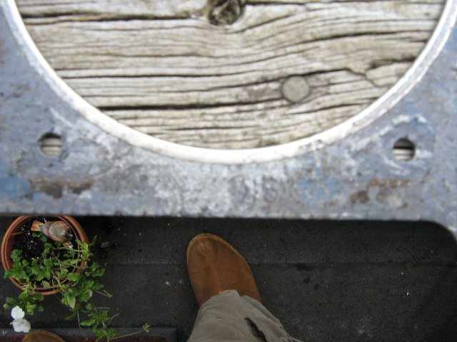

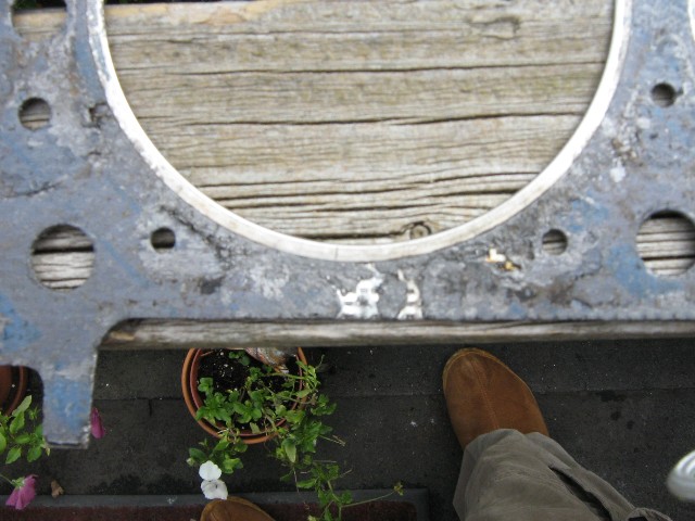

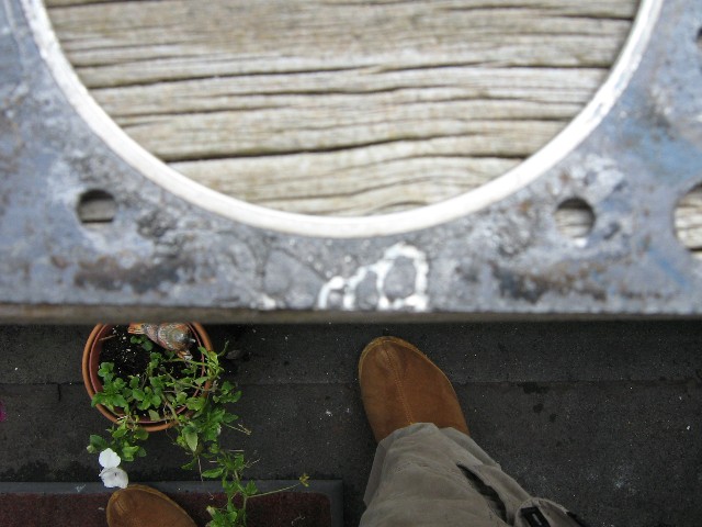

    For those who havn't read my other posts.... I had coolant getting into the oil on my supercharged propane 3.4. Coolant was running out the side of head gasket into the lifter valley. I pulled the head and found pieces of the gasket missing. I looks to me like presure has blown past the fire ring and taken out the material around the coolant area of the head gasket. It has blown right through on #6 and #4 cylinders and looks to be starting on #2 as well. These are Felpro head gaskets, done in April, held down with ARP head studs.
    Has anyone seen this before?

      How many miles on those head gaskets? Were the metal rings cracked at all, or just the gasket material?
      Even Felpro gaskets aren't going to last forever, especially in a boosted application. Maybe go with a thinner head gasket if you can?

        The gaskets have about ~5000 miles on them ...maybe
        The fire ring on #6 had a deep scratch but no cracks. Some discoloring on the top inboard side of the fire rings can also be seen. I can upload a better pic...
