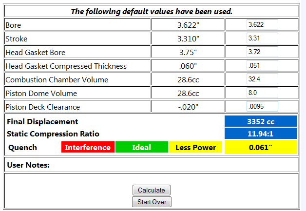

                      well im thinking about using the .051 thickness head gaskets. not much thinner than the stock ones so i should be good with that right?
                      this will net me a 11.94.1 CR. if i use the .036 headgasket thickness to bring the quench into the green i get a 12.54:1 CR. would it be advisable running a headgasket that thin with my cam. i know dave had piston contact with stock headgaskets but his cam is a little rowdier than mine.
                      all of this would be done using the 3500 MLS headgaskets with the 3.72 bore.
                      already have the 3.4 ironhead pistons so im good to go on that area.

                              #59
                              I missed the whole piston deck clearance setting so that's why I had different numbers when I was doing the CR calculator.
                              Stock thickness 3500 MLS headgaskets I would be 11.6:1
                              To get good quench I would end up at 12.5:1
                              my cam specs are in my sig you dope, At least what I know of it... the rest you would have to ask Ben to see if he has any info on the old 1280 intake and 1331 exhaust lobe's
                              Cam 216/240 .050 dur .517/.568 lift 112LSA
                              Its starting to sound like I really can't get a usable CR with stock parts so if I want to mess with this I really need to pick a CR and get a set of Diamond pistons made... Thats gonna be a year or so off then... I guess I'll stick with the .060 thick gasket with my stock bottom end and just make sure to port the shit out of the top end this year. I still feel like my setup was off on the 270hp that I was quoted... so I gotta reach that before doing more to it.
