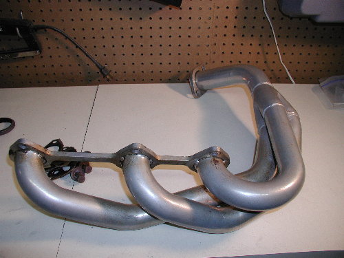

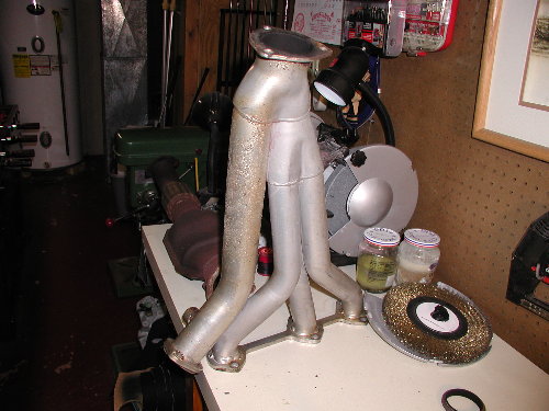

                  i have a couple pix of mine.
