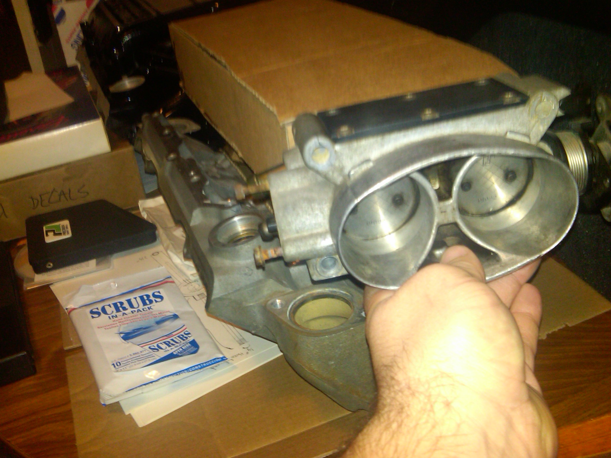

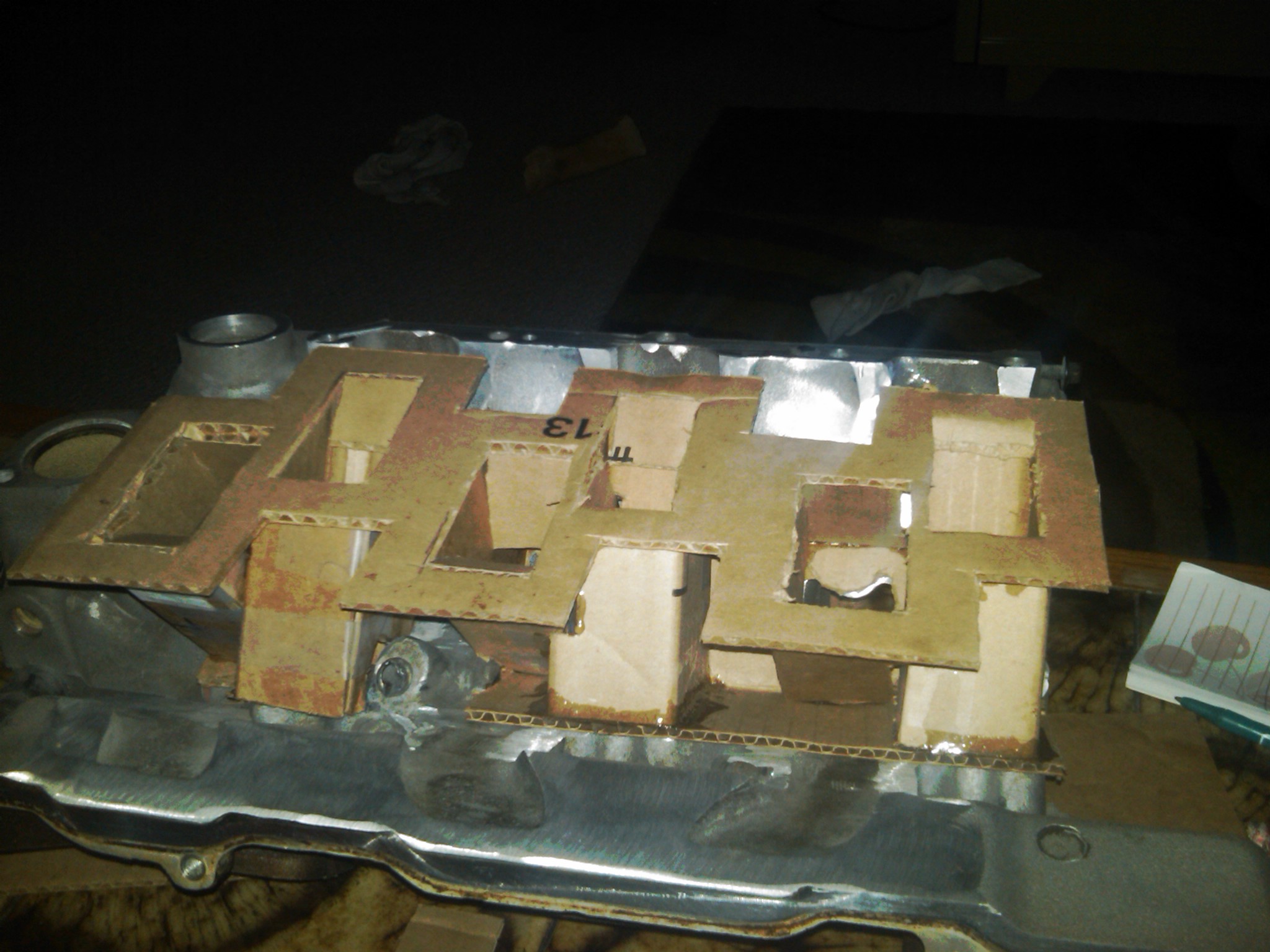

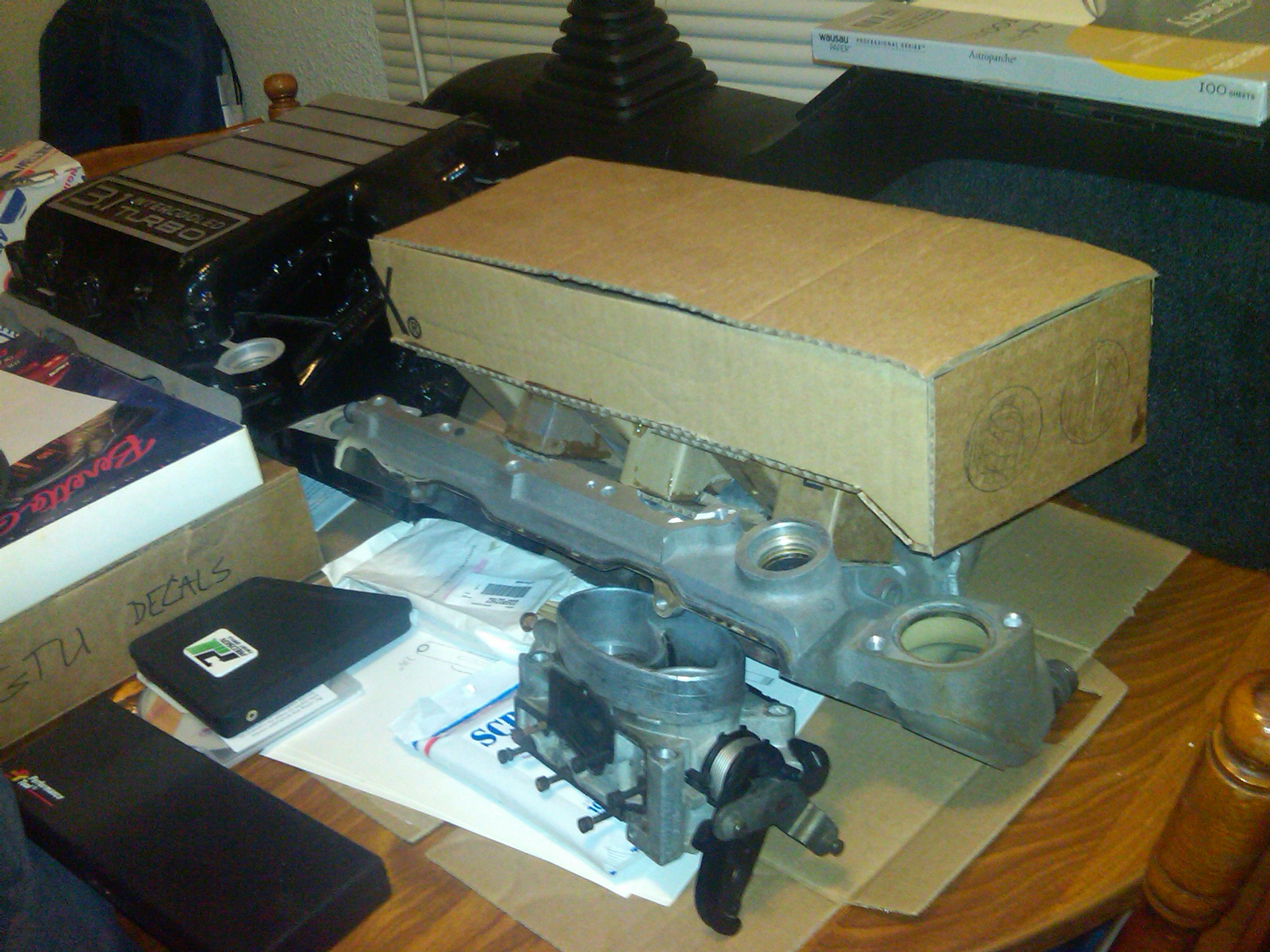

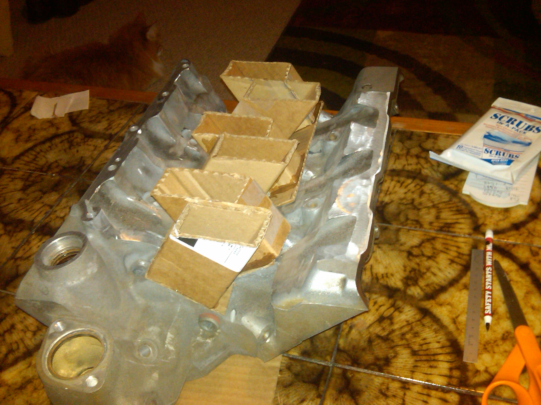

  • JSGTU88
    replied
ID:	376691Click image for larger version
ID:	376692Click image for larger version
ID:	376693Click image for larger version
    I figure this is as good a place as any to throw out my plan/question. I've been looking for someone to make my design a reality somehow. Yes, my design is a rip-off of the 90 beretta pace car design, but who cares, I just want to make the thing. Can anybody help make this happen?
    Thanks!
    Jon
