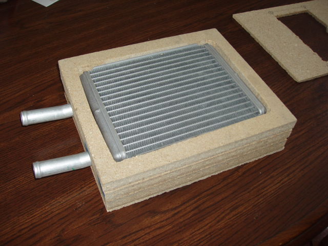

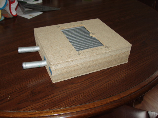

    Originally posted by kwhauck View Post
    Rough mockup with particle board. Initial measurements say that this welded on top of my 3500 manifold with my charger will fit under my new hood. Have to wait for the hood to arrive for final measurements before it gets machined out of aluminum.....
    What, you are not using oak??
