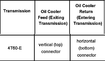

    Now, which line feeds the transmission from the radiator? Upper or Lower?
    I would think lower since heat rises, cool sinks. But Advance Auto Parts sells the line opposing that theory.

    this should help. it's refering to the lines at the tranny itself, so i'm not sure which side of the radiator is the hot side and which is cold....
    • Schmieder
      • Dec 2009
      • 766
      Yes, that helps out A LOT! Thanks
      This info will solve the feed/return issue.
