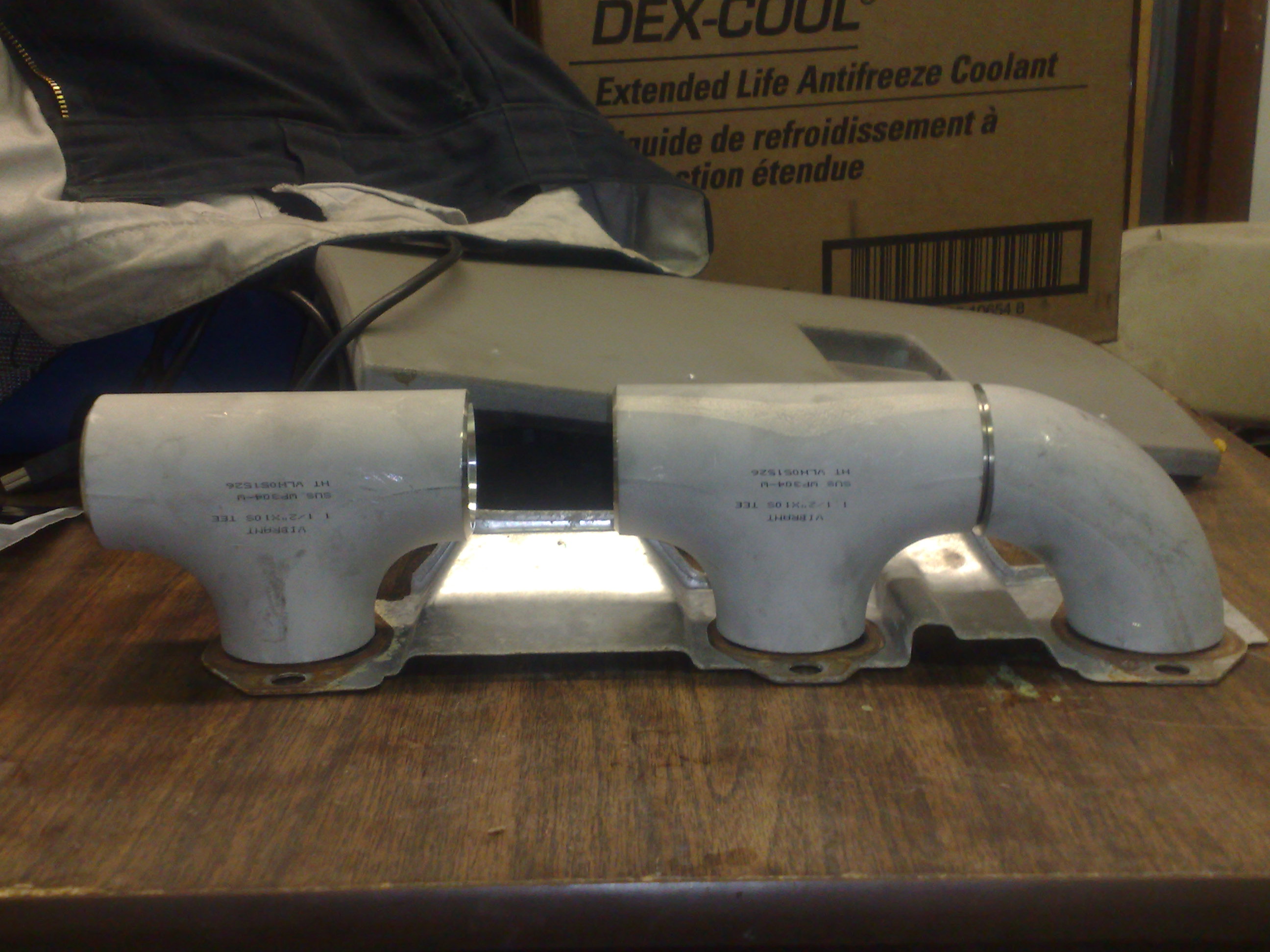

                        Ok, here is the Idea, hopefully is works out.
                        Unfortunately the straight pipe is on BackOrder grrrrrrrrrrrr looking to source elsewhere.
                        T304 stainless steel schedule 10 1.5" (1.89" OD 1.65" ID)
                        Your thoughts?

                          Pretty stiff material, and the tool to make the D shape is not big enough and the elbows keep spitting out

                          • 86FieroSEv6
                            • Feb 2010
                            • 527
                            Maybe a correctly shaped anvil, some torch time and a ball peen hammer will shape it up for you? Sometimes, you gotta get old school.....lol
