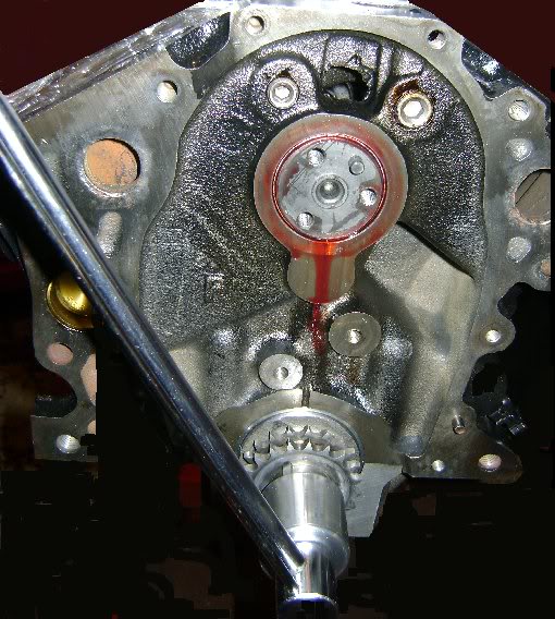

        When you get the timing cover off, put a ratchet on the crank bolt and rotate the engine till the mark on the cam gear and the mark on the crank gear are lined up with the center of the chain guide. That will help you get everything back in correctly.
        you'll have to take out the distributor plug too, or the cam won't come out. just a FYI
        I have one on the stand right now so if you need pics just let me know.

          yeah if you could take some pics that would be great. i want to try to go into this with as much knowledge as possible. and im a visual learner..lol

              This took some glow in the dark paint and a badass UV flashlight..
              I forgot to grab my saftey glasses so my eyes kinda hurt right now.

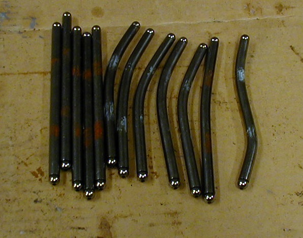

                              In case no one has said it before, be sure to install the pushrods in the correct locations and properly torque the cam gear retaining bolt. Either can be a very costly mistake resulting in bent valves and/or pushrods like the ones below.
