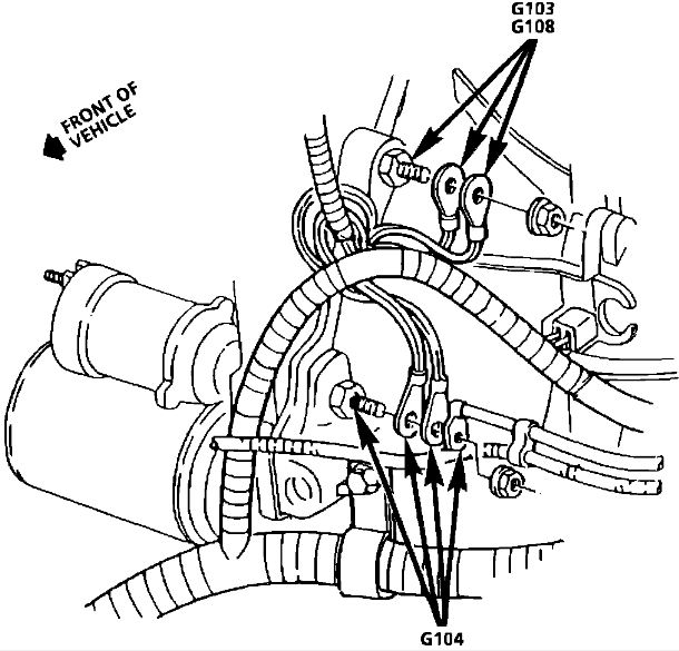

    it's best to ground the ECM to where it was originally grounded. being a 7727, it has to be from a W-body or vette, i don't think anything else got them.

              ok, it was originally grounded close to the starter. pins D4 and C6 are to be grounded at G103, pins A22, D10 and D12 are to be grounded at G104.

                I wired a 7727 into my MGB with a manual transmission, not sure what vehicle you're doing but I didn't do anything with a neutral safety switch and haven't experienced any issues. I believe you'll want to run your grounds to the engine block, that's what I did and I believe that's what was done in the donar car (91 Lumina). You'll want to have a VSS in place. I started out without a VSS and my motor wanted to stall as I came to a stop. That problem disappeared once I added a VSS. In addition, the motor seemed to run better overall...wouldn't go without one. I have a homemade VSS sensor running off my driveshaft and used a magnetic sensor from an early 90's Chevy 4WD truck. I just adjusted the road speed sensor constant. No buffer required for me at least. HTH
