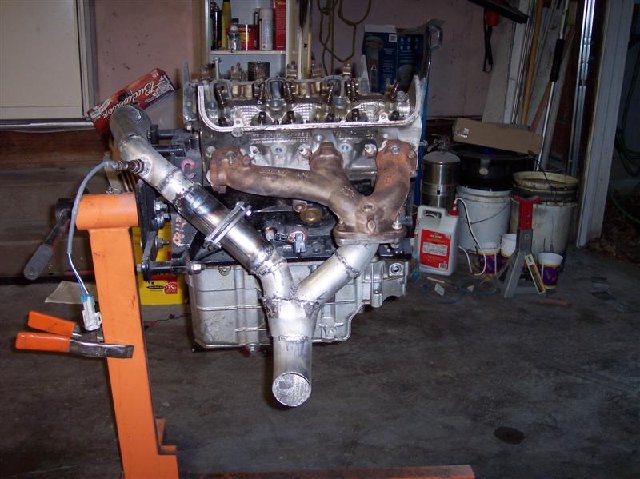

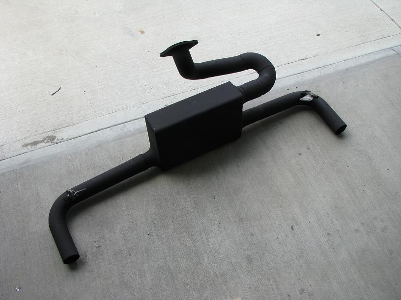

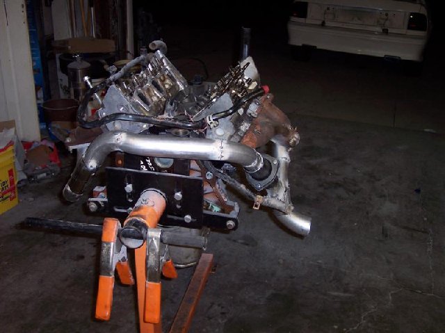

        I am using stock 3400 manifolds on my car and built an exhaust sytem to exit to the trunk side of my engine (rear) it is a tight squeeze but it works. (You could do similar) Here is a pic of my exhaust. I also attached some pics of a 3x00 with two front 3500 manifolds (exhaust pipe setup for FWD car). You can see that the manifold that would be on the trunk side of your engine (in Fiero) is dumping towards the belt end of the engine, not the trans end. This is actually a good thing because it will give you enough space to loop the exhaust pipe back up and over the trans like the stock Fiero system. The other issue to look into first though, is if 3500 manifolds will bolt to 3.1L heads. This I can't answere for you.

          ahh i see now. The 3500 manifolds are similiar to the stock 3x00 manifolds but the dump faces straight down instead of vertical. I had my exhaust setup like that using the 3x00 manifolds but it constantly leaked so i blocked it off and made a y-pipe but id really like to get a tgp style rear manifold. I can tell even by the sound that having the rear blocked and the exhaust rerouted it is more restricted than before.

                    Negative Ghostrider, the pattern is full. Nope I have 3400 manifolds on 3400 heads. The pic I posted of the exhaust (painted black is mine) the other two are someone elses 3400 (I think) with 3500 manifolds. The exhaust routing on the engine in the pics is for a FWD car not a Fiero. If you were to use the 3500 manifolds on a 3x00 in a Fiero you would run the exhaust the reverse of what you see in the pics. It would have the same routing as a stock Fiero. The pics were to show what two front 3500 manifolds look like. Disregard the pipeing on the last two pics.
