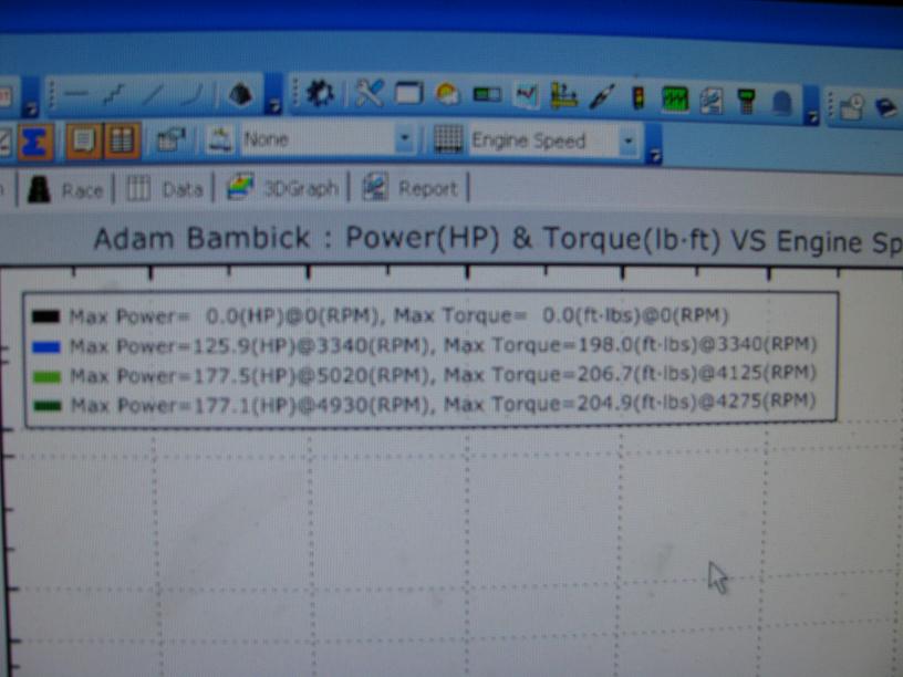

    I have 2002 3400 froma grandam gt. I have a FWD 5 speed getrag trans. no ac, no power steering, 2.5" exhaust witha spintek muffler, dry cone filter and a "ram air" intake.

              There is probabley a couple more hp left in the motor too with some tunning. When I did that dyno run my engine was running off a stock tune for an '95 iron head 3.4. I have since upgraded to the 7730 with the 3400 tune from WOT tech. I haven't dynoed since changing the computer.

                    I agree with Rootie. It's NEVER a bad thing to intercool a boost setup. I'm not experienced with boosting 3400's, so I'll leave the 7psi question to someone more qualified. But, FWIW, with one atmosphere (14.7psi) if you are pushing 178, you should theoretically see almost an 89 hp increase from running almost another half atmosphere of pressure (in a perfect world).

                      Stock 3400 5 speed swapped jbodies put down 180-200 WHP all day long depending on the dyno.
