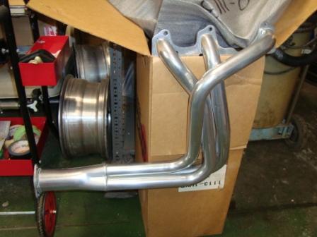

    I replaced the injection with an Edelbrock intake, a Mallory dual point dizzy, a really big cam (I have to look at the specs, but it sounds like a pro stock rig with open headers I think the lift is in the high .492(?) and duration is .292 advertised), I advanced the cam 4* (true roller chain), a set of headers running through a 3 inch exhaust and cat, a set of crane 1.5 rocker rollers, ( a rocker stud broke(!) I am guessing from the cam having big lift) and a 390 CFM Holley 4 barrel. It has a 5 speed, and a 4.10 posi rear end. I still have to dial it in, it ran a best of 16.3 with NO traction in first and part of second. I have to look at the 60 ft times to see how bad it was. Reaction times were around .2 or less. I was hoping to see 14s, and even with a good off line hook, I don't think it's going to happen. It was REALLY hot at the track the day I ran, maybe cooler weather will help out alot.
    This thing pulls REALLY hard about 3,000 RPM on, I'm pretty sure I get spring float after 5K cause the springs are stockers. I guess I still have some tuning to do, maybe a set of heavier valve springs and an electronically controlled iginition system, rejet the carb, dial in the iginition timing curve. I suppose I should gasket match port the heads and maybe some light bowl work.

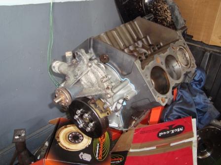

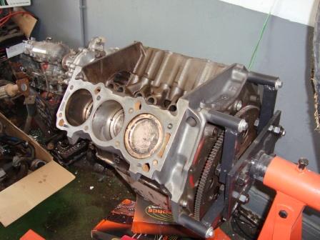

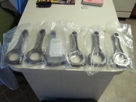

      I have a 3.8 Grand National Buick engine on an engine stand that is going in this S10. It has 10 to 1 pistons, cutom rods, Fluidampr, balanced, custom ported heads, intake, 455 CFM Holley, MSD ignition, coated headers, big cam similar to the 3.4, 4* advance on the cam, performance valve springs, retainers and keepers. I am not running the turbo, I want to see if this will go into the 12s all engine. It is also set up for a 5 speed. I also have a complete spray set up adjustable to 250 HP.
      When I pull the 3.4 out, I will go through it and do everything - balance, ARP, rods, pistons, head port work, springs, etc. I will probably end up installing it in an Isuzu Gemini coupe (Buick Opel in this country) that I have sitting in my barn.

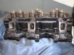

        Well if your still interested in finishing the 3.4L then at bare minimum just fix up the springs and if you feel like it gasket match the heads. But that will require removing the heads and valves.

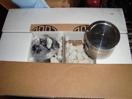

            I am going to finish the 3.4 with pistons, balancing, and detail to the reciprocating parts - including ARP and hopefully some nice pistons. I don't know of anyone who makes compression pistons for a 3.4 with iron heads. I want to run a primitive carb / distributor setup for ease of installation because I'm not at home. I just don't think that there is alot of streetable fast power out of one of these units - like a 12 second street engine. I like these engines, they are small and have plenty of possibilities.

              Well GM did make 12:1 pistons for the 2.8L but I don't think you can get them anymore. Flat top DOHC pistons will bump up compression some but they are not forged. Custom forged may be the way you need to go.
