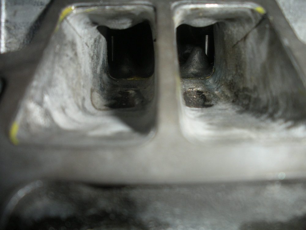

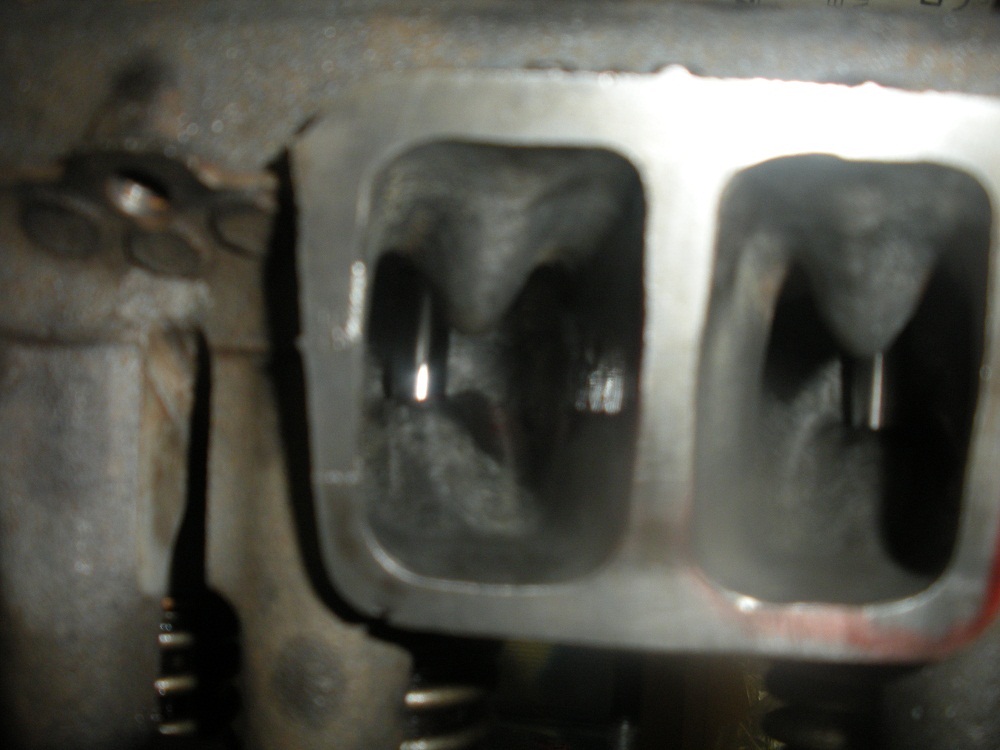

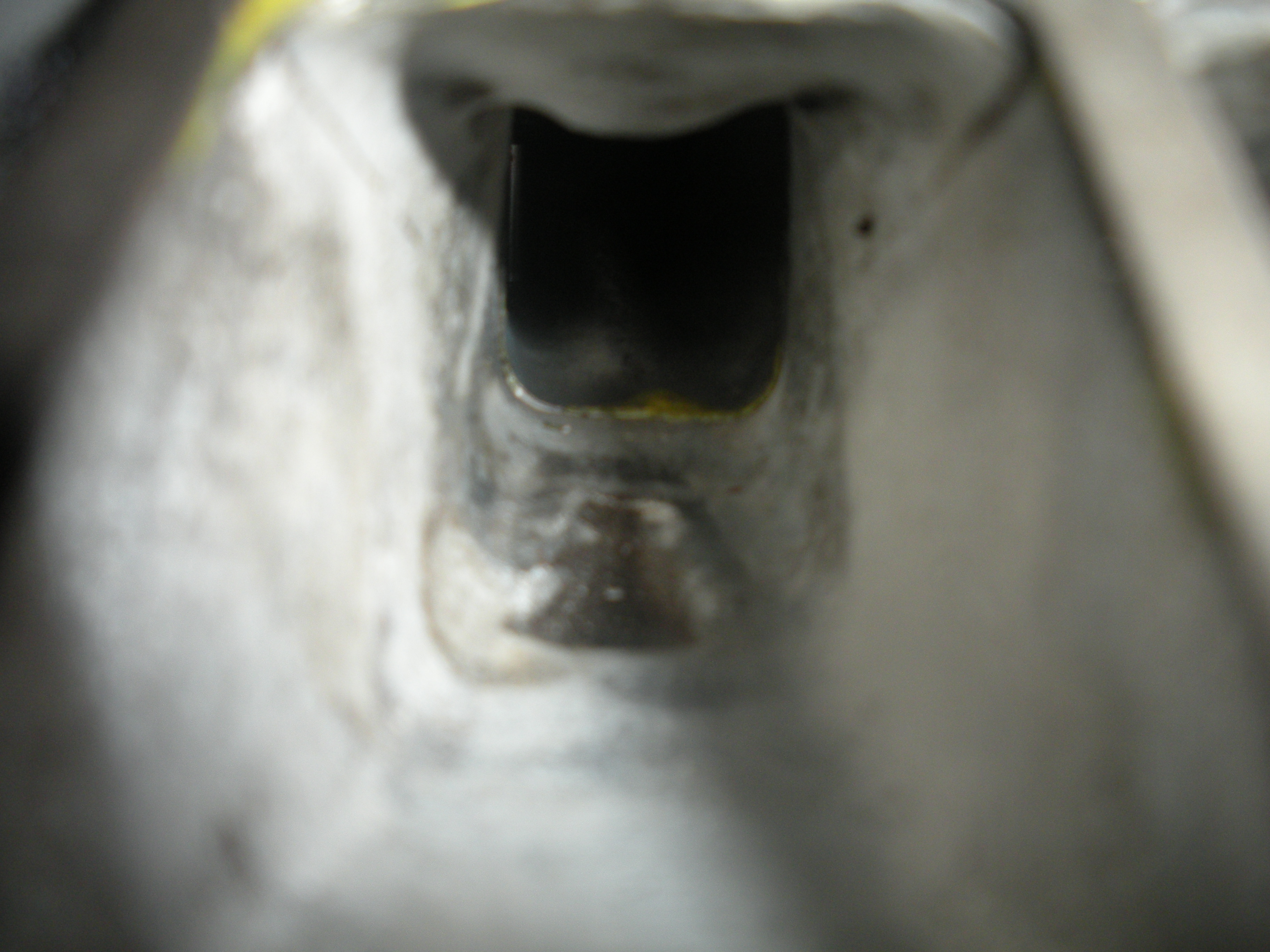

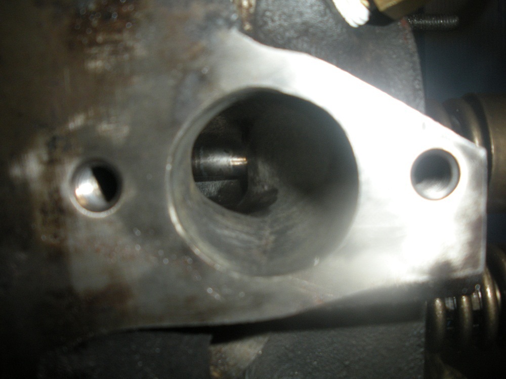

        polishing can be a waste of time if ur on the street. i recintly went through my 2,8 top end gasket matched everything and mild port just to help flow and transition and yes i did go through the heads as well and yes be very carefull of the diverter the little pointy thingy in the intake port of the head i cleaned mine up a little smoothing and transition but kept it just remember think like a air molicule they are dumb and dont know how to drive lol Click image for larger version
ID:	376595Click image for larger version
ID:	376594Click image for larger version
ID:	376593Click image for larger version
