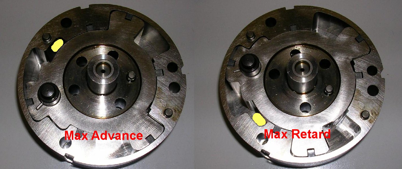

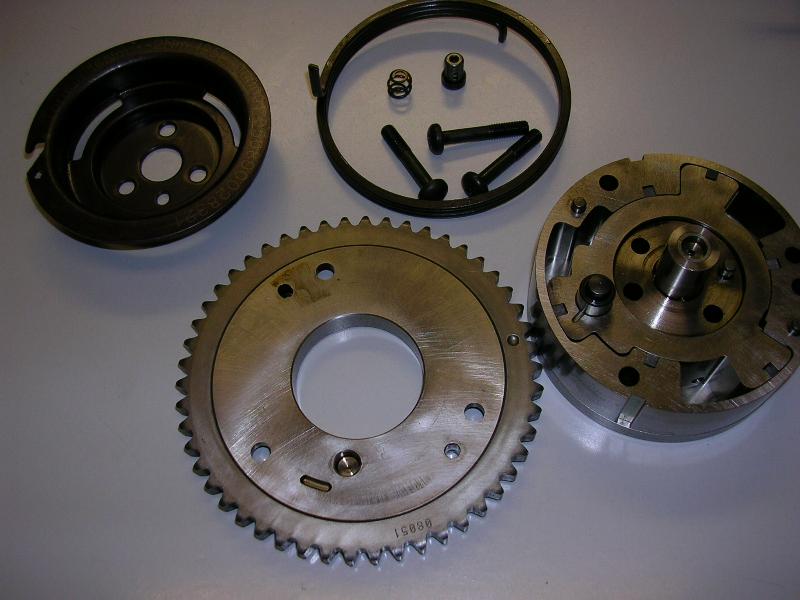

    so your saying set it up to be a 2 stage setup, instead of infinitely variable? does anyone have detail pics of the phaser? maybe it's something that could be machined for better performance?

        Here's a couple of pictures of the phaser disassembled and showing max advance/retard.

          Thank you CNCguy!
