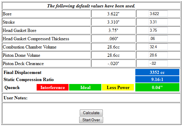

          Ok, here we go...
          First, we have your current setup:

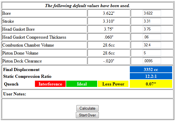

          Next is iron head pistons and aluminum head gaskets:
Name:	iron pistons alum hg.PNG

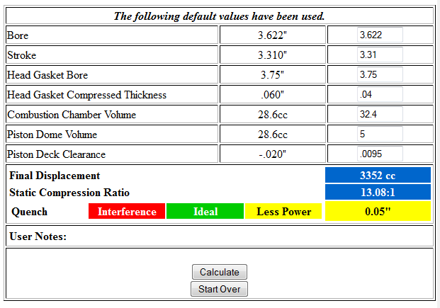

          Next is iron head pistons and iron head gaskets:
Name:	iron pistons iron hg.PNG

          All this info is available in the CR calc. That's why I pointed you to the article, as it explains how to get values from other engines, as well as gives an explanation of what each of the inputs is. All you need to do is load up whatever engine you want to use parts from (the 3.4 iron head, 3.4 DOHC, and 3500 in this case), and write down their values for the parts you want to use. Then, load up your engine (3400 in your case) and select User Entered Values, then type in the various numbers for the combo you are looking for.
