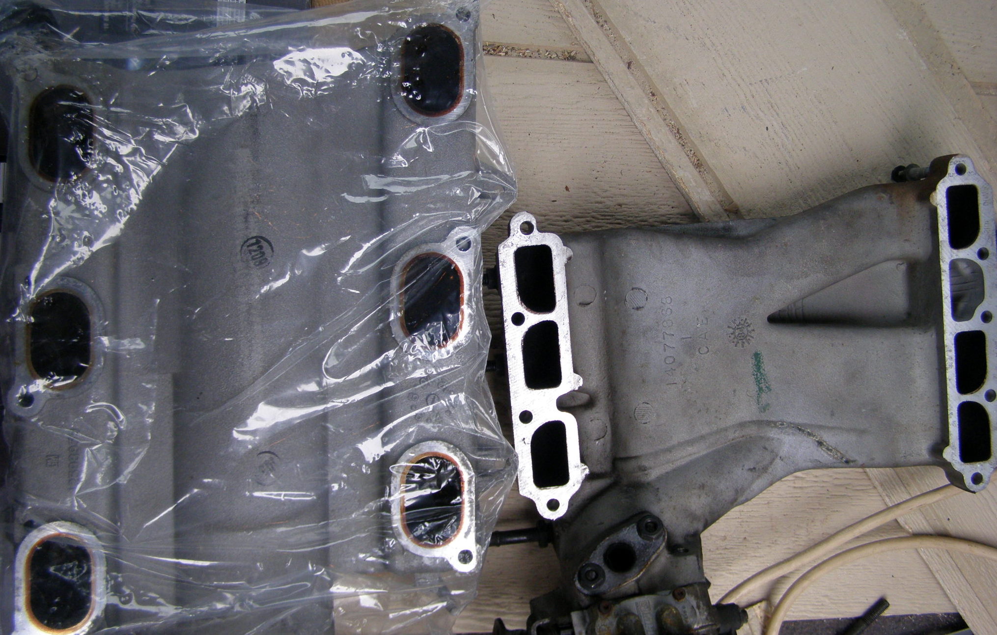

                  I should get 200-210 HP at the wheels, which means around 240 HP at the crank. So it is a gain of 120 HP over my old 2.8 rated at 120. Plus my torque ratings will jump from 155 lbs to around 240-250 lbs. And that power is available through much more of the RPM range so it pulls longer. You can spend the $1400 on a performance kit from ARI Engines and still be far short of the power of the 3500. I bought my 3500 for $450 and it only had 30k miles on it, and all the other stuff I needed for the swap has totaled around $1400 including the cost of the engine.
                  Just look at the size of the plenum. The 3500 is much larger and produces much more power at higher rpms than the 2.8 ever will.
                  • GEARS
                    • May 2010
                    • 37
                    Boy... that last picture sure puts things into perspective...
                      No joke. I knew there was a difference, but I didn't realize there was that huge of a difference O.o
