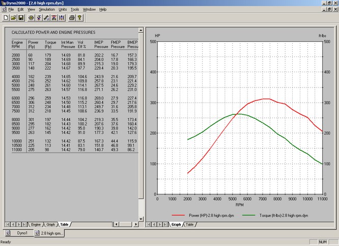

  • dskopek
    replied
    I sat down with a cold one last night and looked thru this thread and found the bore/stroke and cr, cam spec's and installed cl. Head flow numbers, all that good stuff and punched it in to a dyno program just to see how it ends up. Real interesting on how it responds to intake style. Click image for larger version
Name:	2.8 IR manifold.jpg
ID:	377298Click image for larger version
Name:	2.8 Single plane manifold.jpg
ID:	377299Click image for larger version
Name:	2.8 Tunnel ram manifold chart.jpg
ID:	377300Click image for larger version
Name:	2.8 Tunnel ram manifold.jpg
ID:	377297 Big change going from a IR setup to a single plane or tunnel ram set up. Makes you wonder just how good the dyno program is in this case! 330 HP 2.8 would be something to see.
    This is with no changes to cam or carb!
