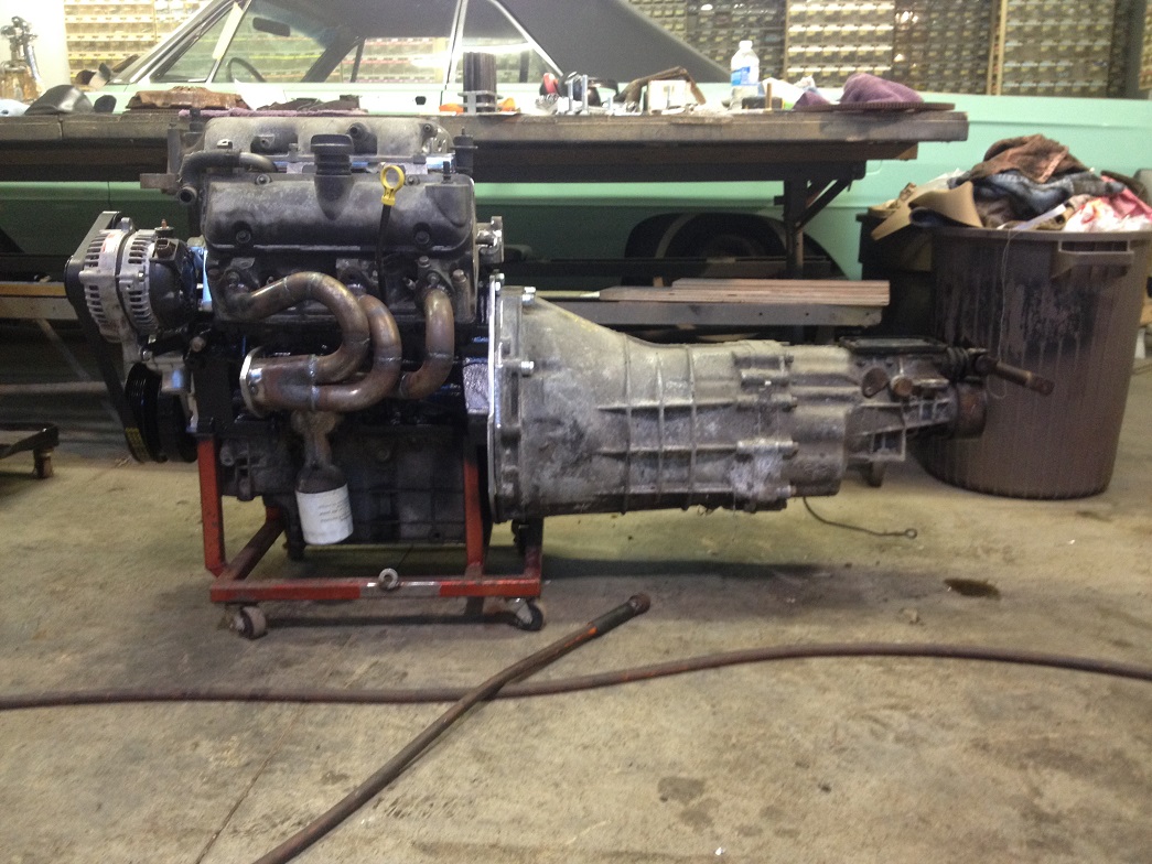

  • ericjon262
    replied
    Here's version 3.1, my biggest concern is spark plug access. with this design the number 6 primary might be in the way of access to the number 6 spark plug. the longest length is just under 10", the shortest is just over 8"

  • ericjon262
    replied
    Version 3.0...
    not really all that close to equal length, but as the gas velocity goes up, the distance becomes a smaller and smaller part of the big picture. as an added benefit, this design would cost quite a bit less than most of the others previously shown. I can potentially get them closer to equal length by adding spacers in the 180* bend in the #6 primary.it would be super awesome to have a rendering of a 3500 F23 setup right now to do a digital test fit... oh well, just have to take lots of measurements on the one in the garage and verify fitment that way...
