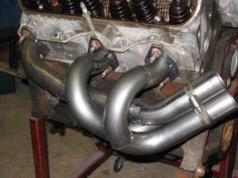

    If you think that the primary will get in the way of accessing the plug(s), which it doesn't look like to me, bring it out on more of an angle and wrap it around the other primaries.
    This is how I did mine and have no issues with spark plug access (also a huge concern of mine along with bolt/stud access for actual install and removal of the headers).

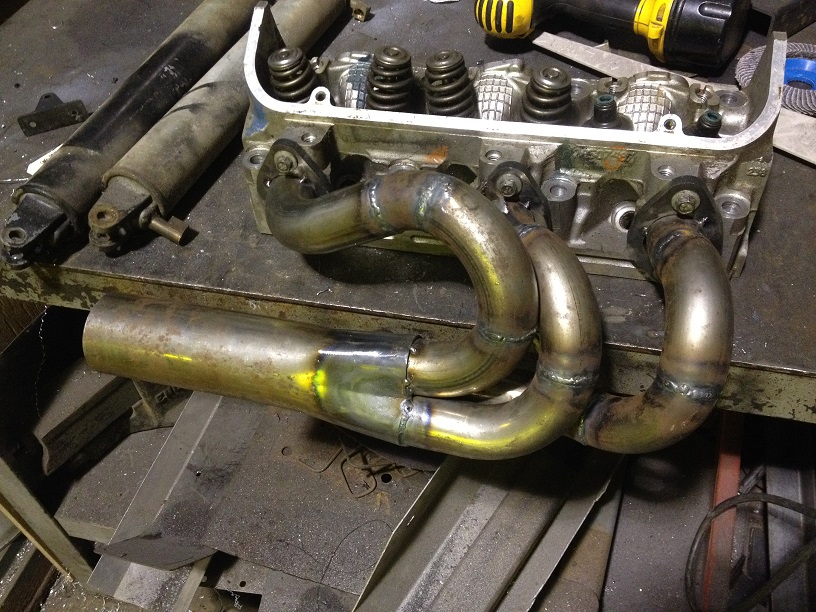

    Here is a front header I built for a turbo Cavalier, where I mounted the turbo above the rear head/rocker cover. Doesn't exit the same place as yours but could be shortened up to do so. I LOVE the look of this header and without even trying all the primaries were within 1/2" of each other's length.
