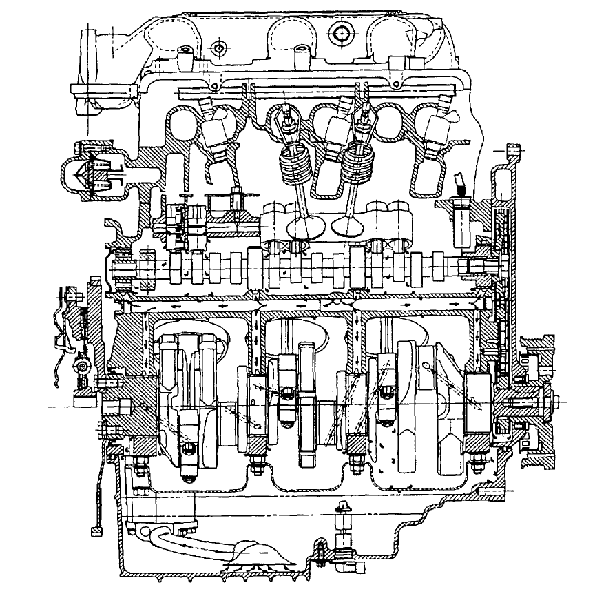

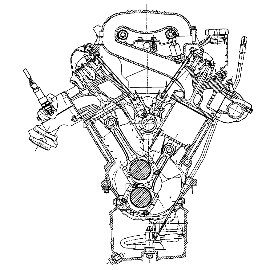

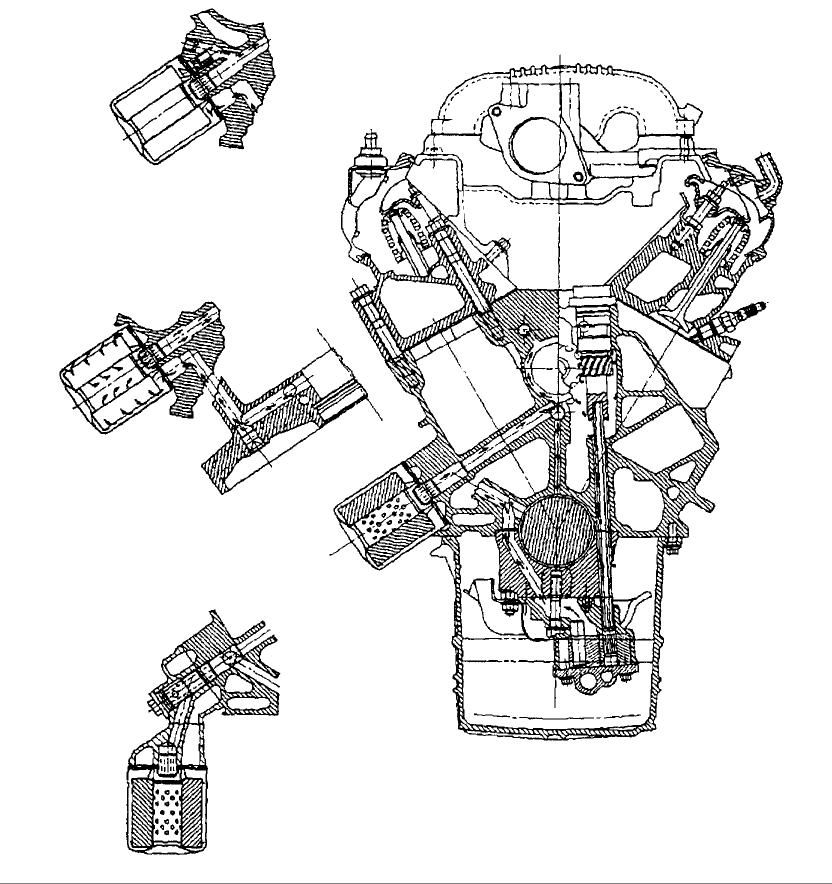

            If it was the valve job, the issue should be universal across all lifters. Maybe use top end cleaner or oil with detergents. Supposing the 4 might have a little coke build up in route to the lifters? Not sure....here are the oiling maps for my 3100. Probably exactly the same for your block too.
Name:	Right 3100 oil.gif
ID:	377107Click image for larger version
Name:	Rear 3100 oil.gif
ID:	377108Click image for larger version
Name:	Front 3100 oil.gif
