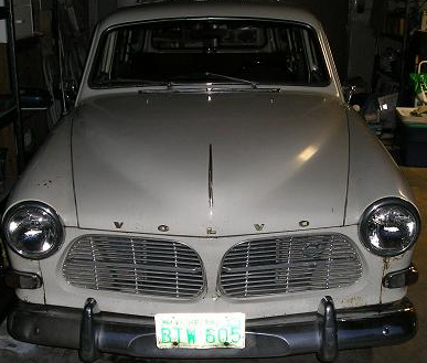

    Just thinking here before I get all worked up and try to source a 3500 for an upcoming
    vintage car swap.
    Any low points or concerns?
    Thanks in advance!
