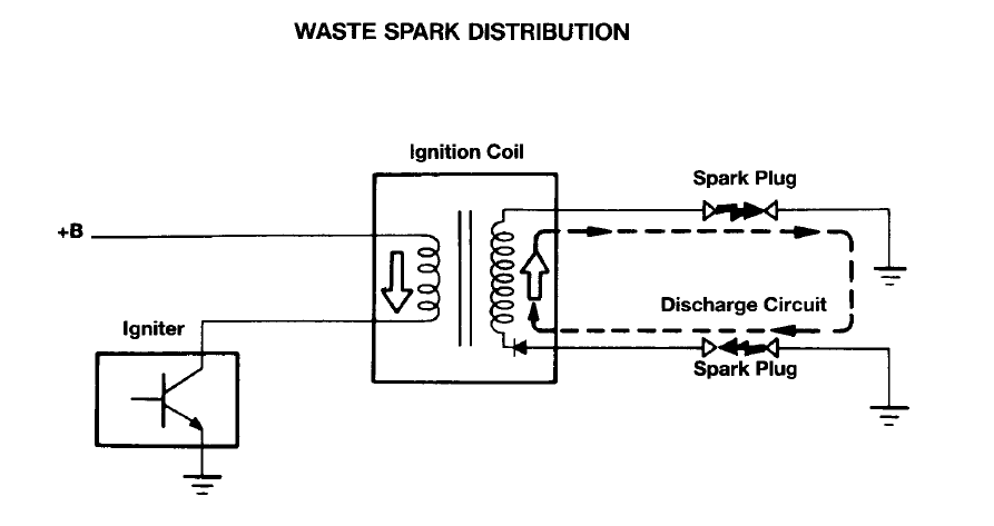

    Isn't there a diode on one side of the coil? I believe there is.
    Even though it appears the same spark on 5 and 2, one is flowing towards the coil and the other is flowing away. I really can't be sure if the coils you/we use have such a diode. I don't see why not, the current is always going to flow one direction opposed to the trigger current discharging. And I know the ICM circuits don't flip the current back and forth......
    This might have something to do with this quagmire spark thing. Maybe a ground loop is occuring somewhere. They can be known to cause some funky issues in electronics.

      i don't think there is a diode in the GM DIS coilpacks... i've never tested it as such though.

        I never thought much about this until now, strange to think our plugs fire in opposite polarity. At least as far as I can tell (in theory) they do.

          they indeed fire that way. a lot of Fords did as well, they kind of ghetto'd it though... once they started using platinum plugs, they only put the platinum on one side... on one bank it was on the ground strap, on the other, it was on the center electrode... had to do with the direction the current flowed, but i can't remember which. GM just put it on both sides.
            #155
            That would have someone heck of a diode to stand that kind of energy.
            Easy enough to check. Resistance test the towers both ways. If you only get a reading one way there is a diode, get a reading both ways and there is no diode.
            I've never bothered with polarity with coils, so I would imagine there is no diode.
