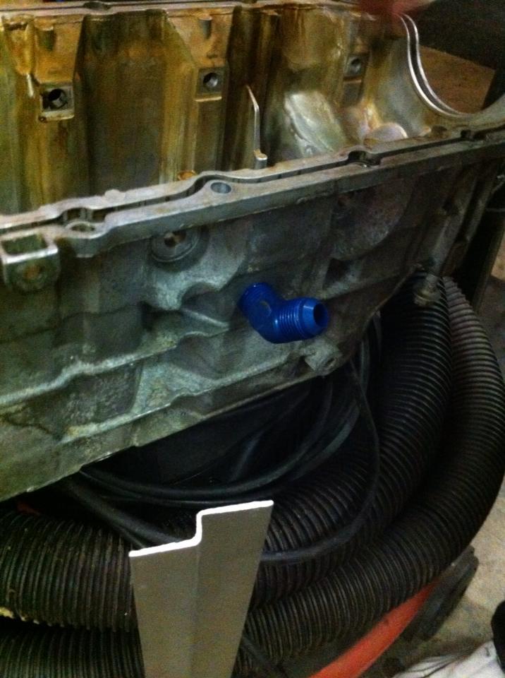

                      Finally got around to putting my braided hoses together:
                      Fuel hoses; return line comes from the schrader valve for now to the FPR
                      Oil drain
                      Oil feed from beside oil filter
                      And picked up a turbosmart boost controller for $20. I'll probably upgrade to an EBC later.
                      Hopefully I'll finish up the engine part of the wiring over the weekend.
