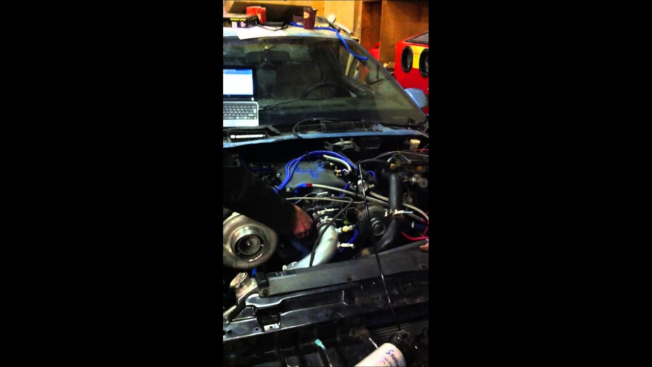

    Cyl #1 is supposed to be the one closest to the accessories, correct? I double checked the plug wires twice last night and I'm pretty sure they're correct. Here's the vid:
    Fuel pump seems to be working fine. It seems like every time the engine stalls it's getting too much fuel and we have to unplug the fuel pump relay before it will start again. Right now the fuel pressure is set at about 45psi. I'm going to try a different tune to see if that makes any difference. I've already tried leaning out the current tune quite a bit with almost no change.

    Started it up last night but either the tune is way off or it's misfiring. Either way it won't idle and seems to only fire when the throttle is in motion... I'm going to check the injectors and try a different tune. I do have a vid ill upload tonight. Wideband is reading around 11.5 when it does run so it would seem not too rich to idle. Fuel pressure gauge jumps around while engine is running.
