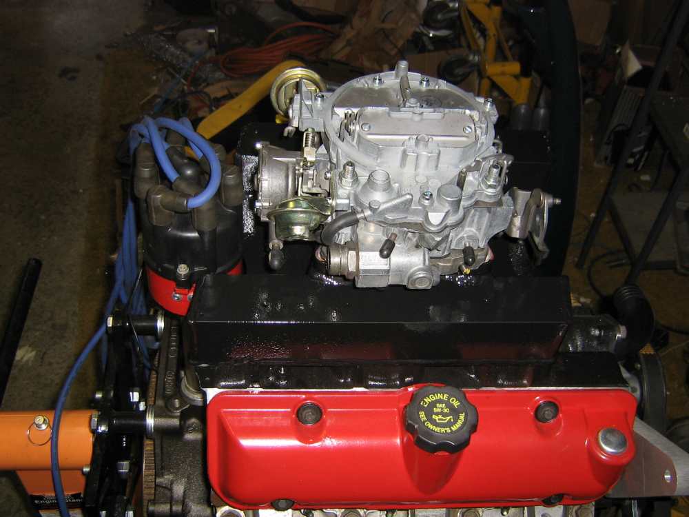

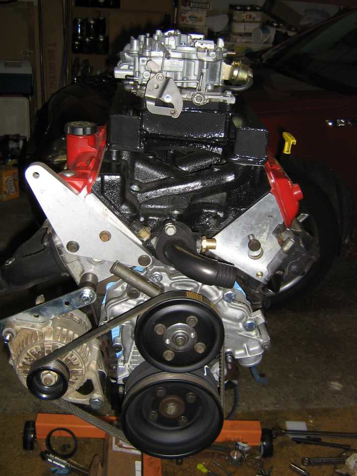

                        I have one. Larry

                          trottelg,
                          you really need to rotate that Q-jet 90*, you're not going to get optimal distribution with it that way at all, which will double hurt you since you are on an EFI manifold.
                          • trotterlg
                            • Feb 2011
                            • 326
                            I know you keep telling me, but the primaries will either be offset to a bank or to the front or rear of the engine, I choose the offset to a bank so at least it will be even to every other power stroke, that, and the Qjet is built to run oriented fore and aft, so I guess we will see how it works out. Larry

                              how did you go about doing that? looks like a pretty good setup a bit tall though but worth it
