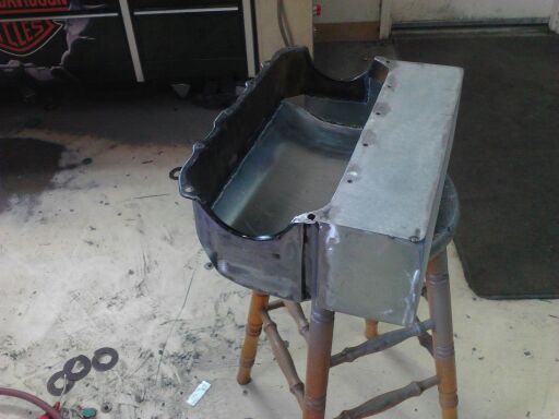

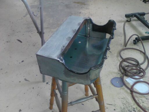

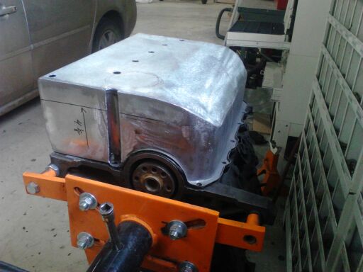

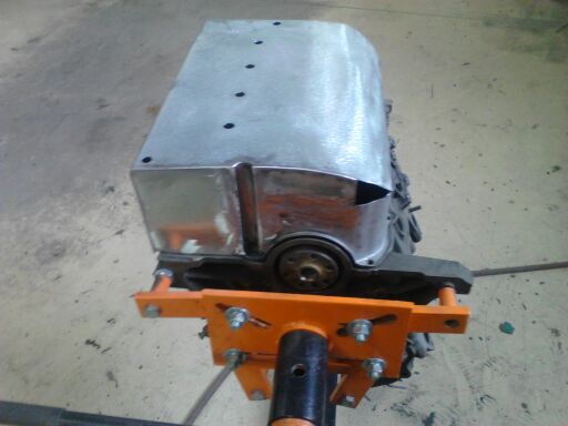

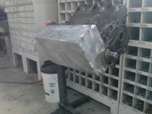

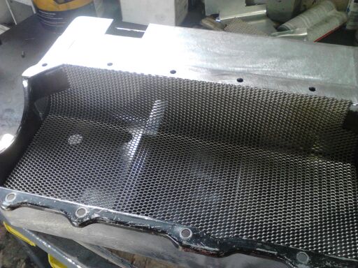

ID:	381204 Started on my shallow pan today.

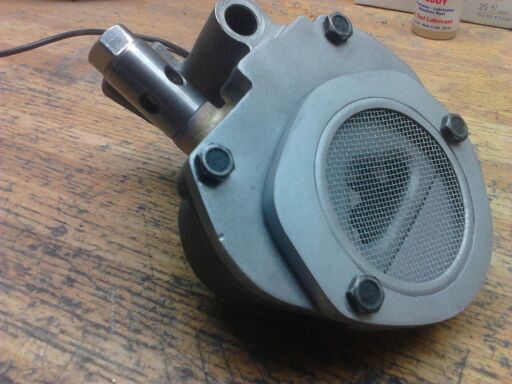

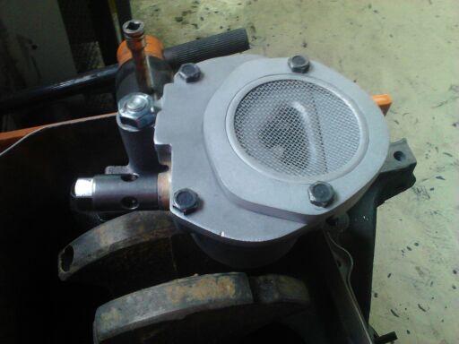

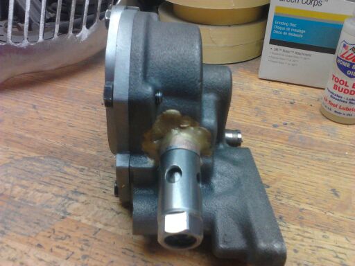

ID:	381210 The oil pump is a 3900 pump modified to have a bottom intake and external bypass.

    if it was going in a generator or other stationary assembly, I would say it's fine, but in a car, that's a no-go, either your crank will be halfway submerged in oil, or anytime you stop go or turn, you'll suck air.

      I'm wondering the point of a shallow pan.

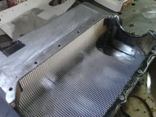

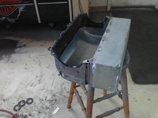

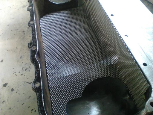

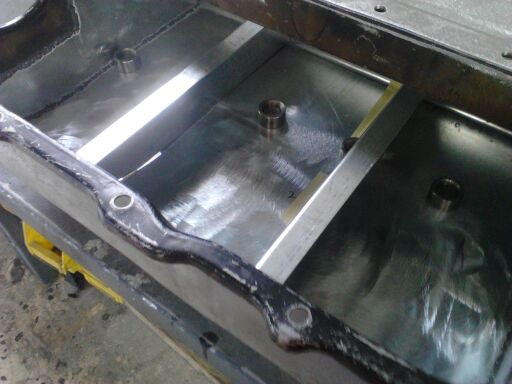

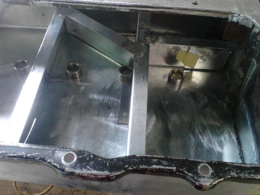

        The oil pan will have internal baffeling with trap doors like road race pans, to keep the oil around the pickup, the pan capacity at 2" oil depth is around 7 quarts. I'm also going to run a crank scaper and a windage tray. Barnes oil pumps built a similar type pump for an internal dry sump that was used for many years by sprint car engine builders in the late 70's and early 80's.
        • 23TrackroadsterV6
          • Jul 2011
          • 60

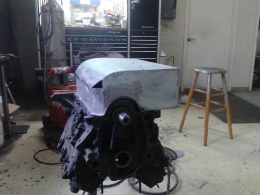

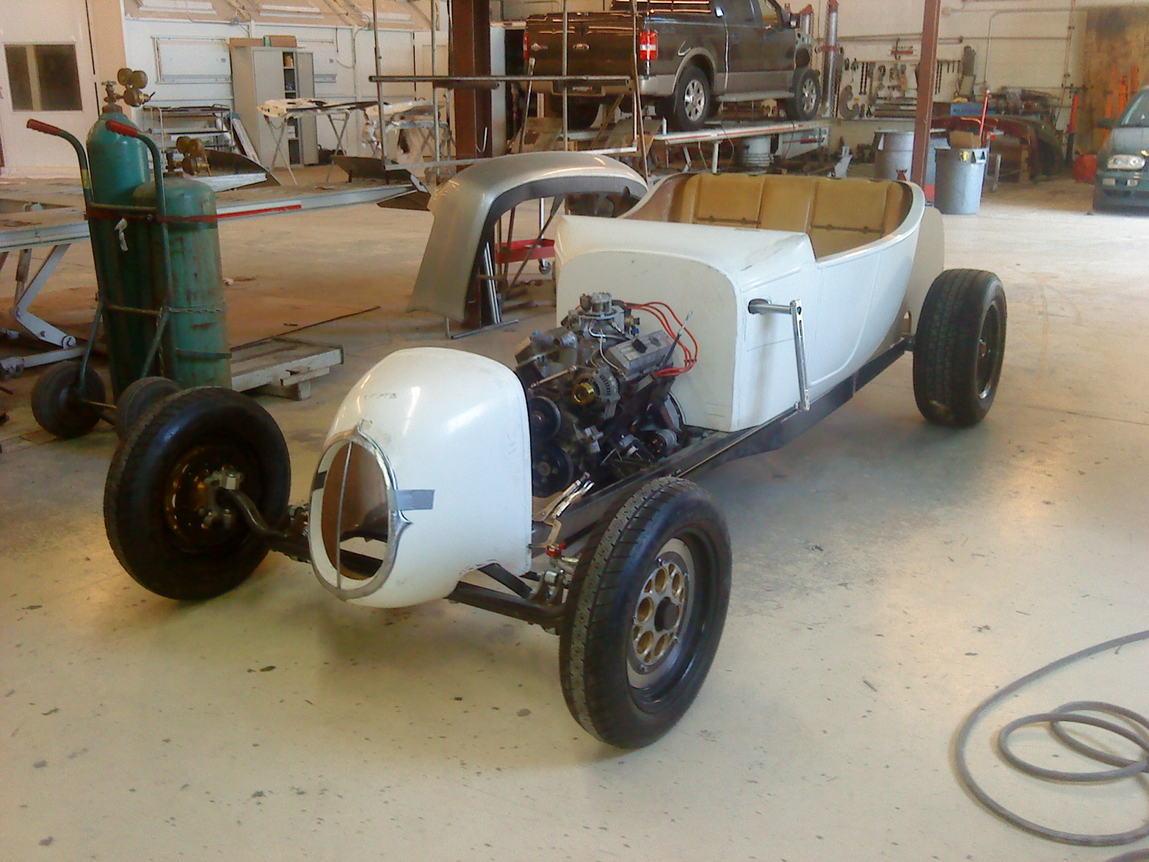

          Reason for the shallow pan is ground clearance. This pan is going on a 3.1 Isuzu in a 1923 Track roadster and itClick image for larger version
ID:	377338 sits low in the chassis.

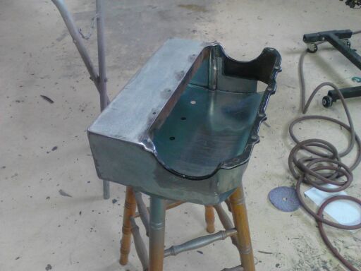

              More progressClick image for larger version
ID:	377339Click image for larger version
ID:	377340Click image for larger version
ID:	377341Click image for larger version

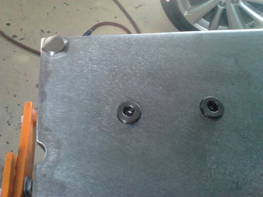

                      A little more progress. Click image for larger version
ID:	377362Click image for larger version
ID:	377363Click image for larger version
ID:	377364Click image for larger version
ID:	377365Click image for larger version
ID:	377366Click image for larger version

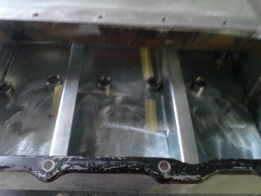

                        I have a basic question. How are you going to check the oil level? Just because I'd like to know, I don't know much about race style pans.
                        Grand Prix trans with 3.33FDR
                        • 23TrackroadsterV6
                          • Jul 2011
                          • 60
                          It will have a dipstick, same as any other oil pan. It will have to be custom made to the correct length and marked with proper level when it has 6 quarts of oil in it.
